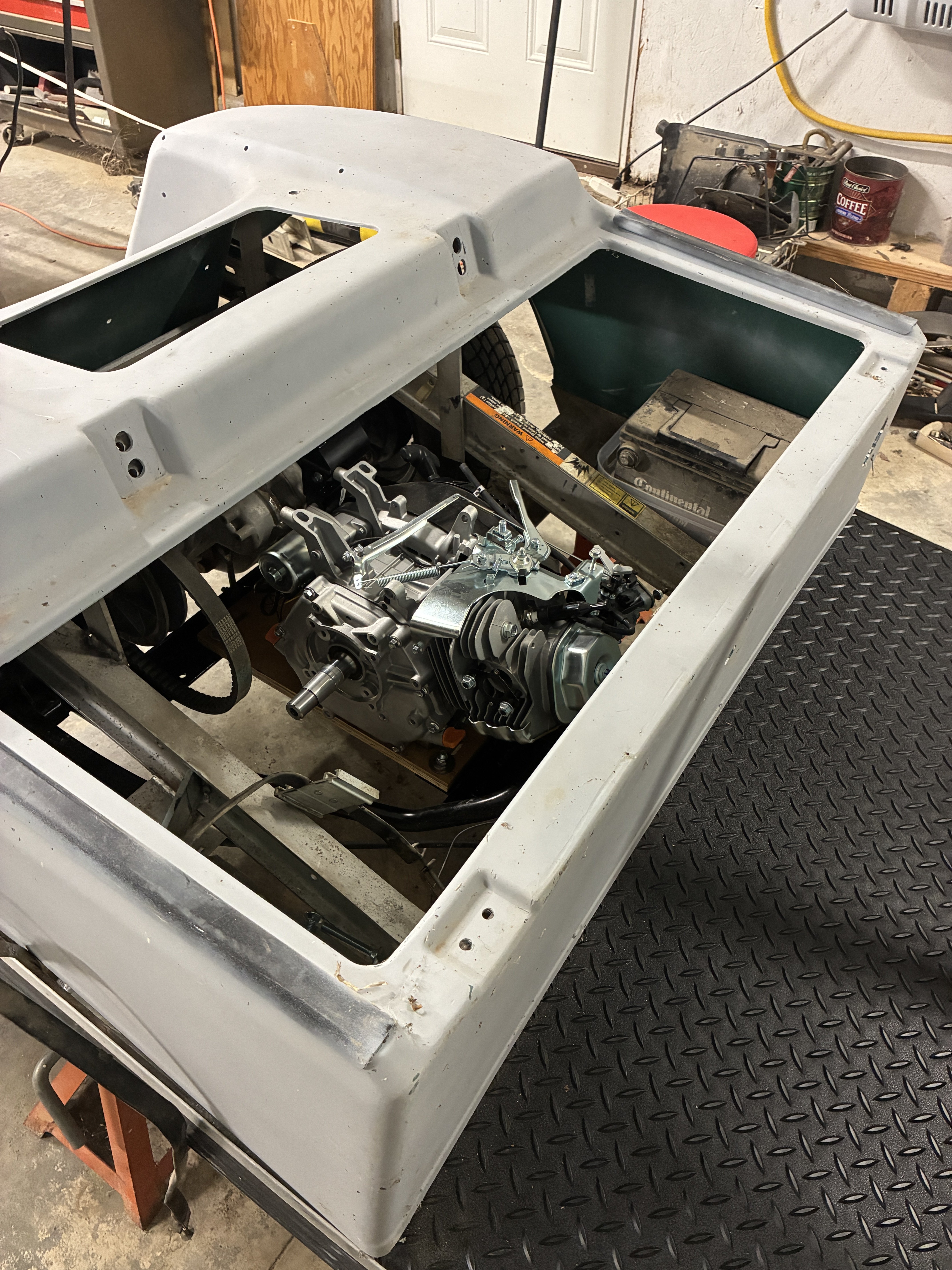

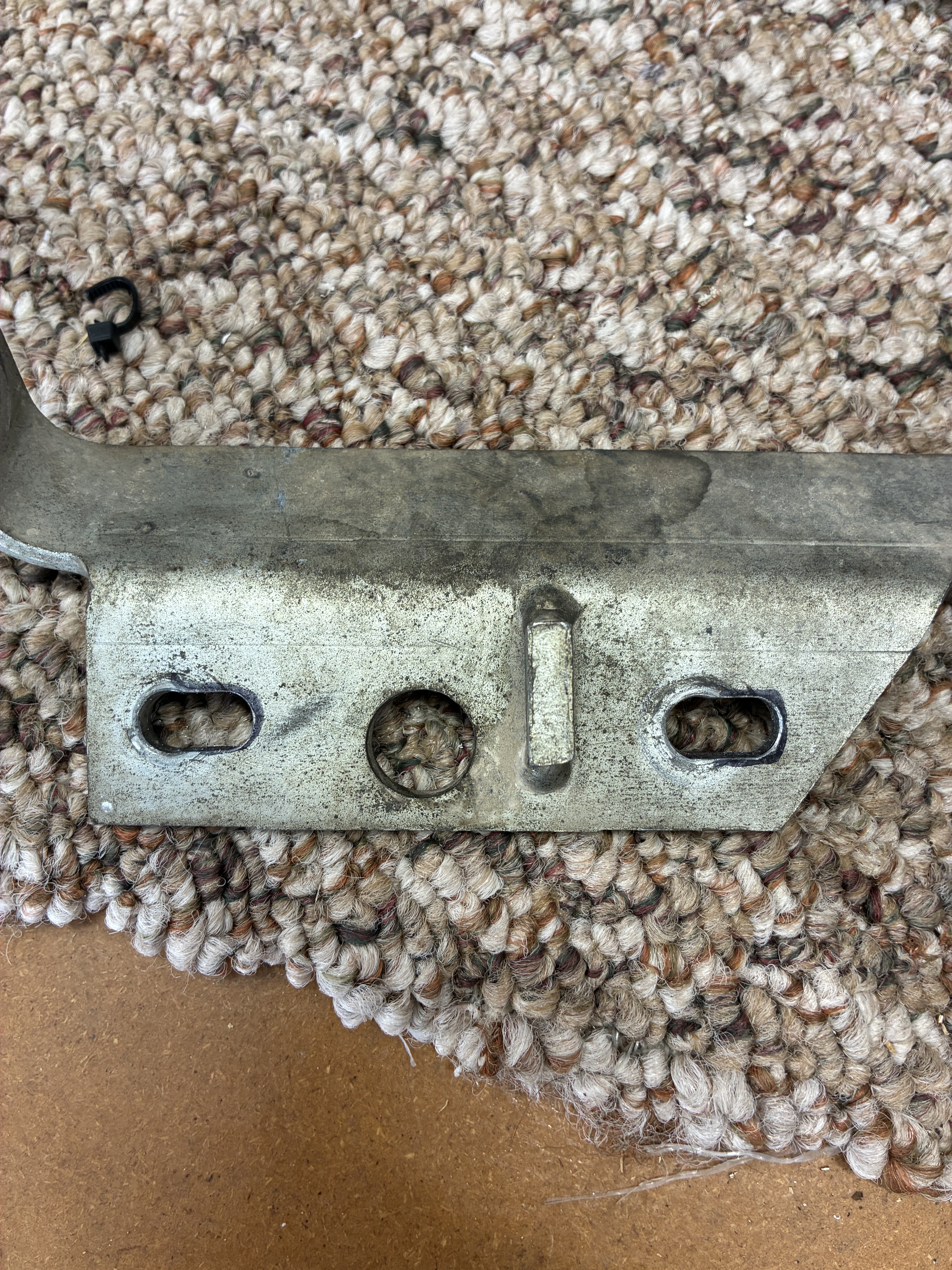

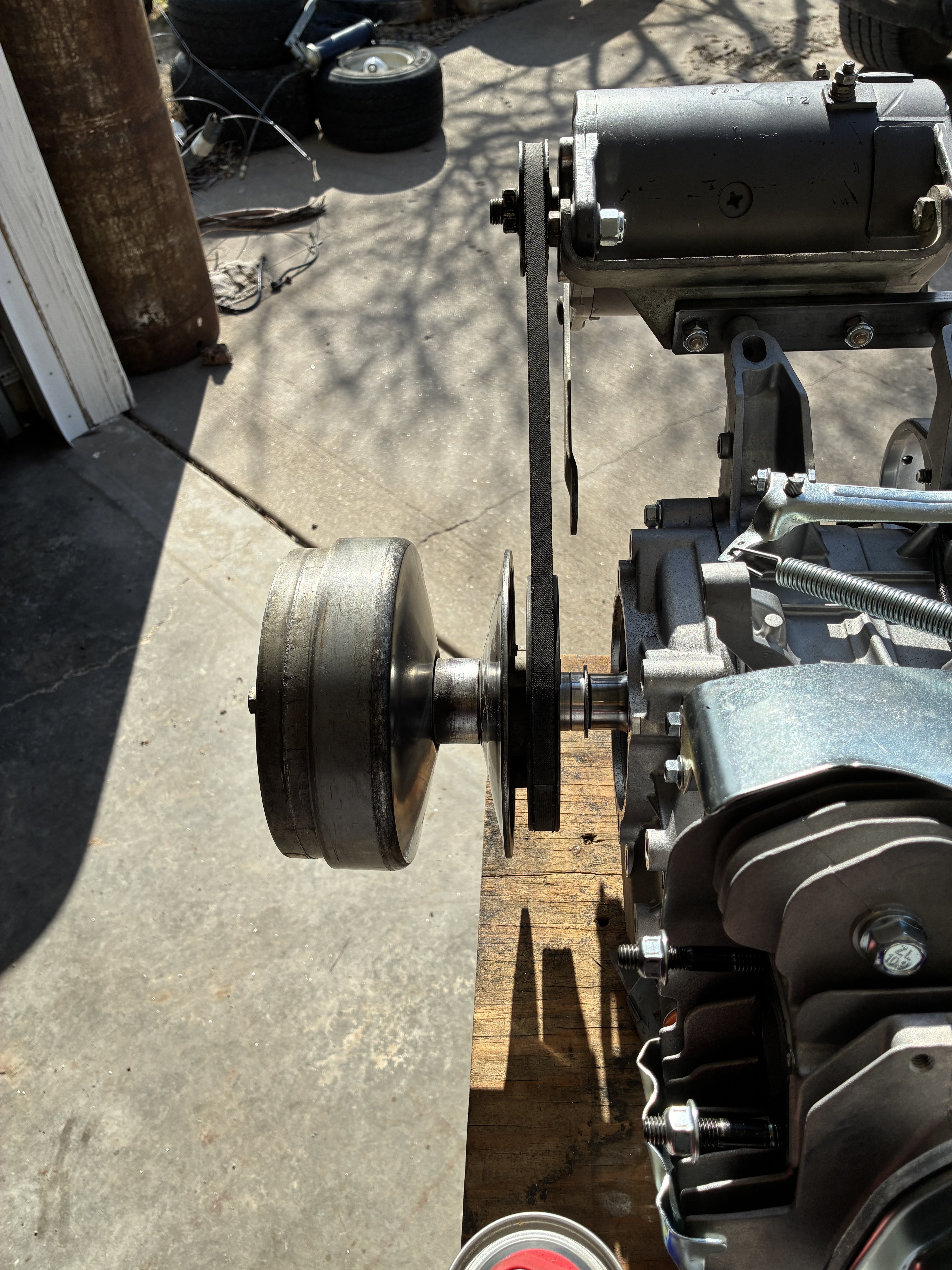

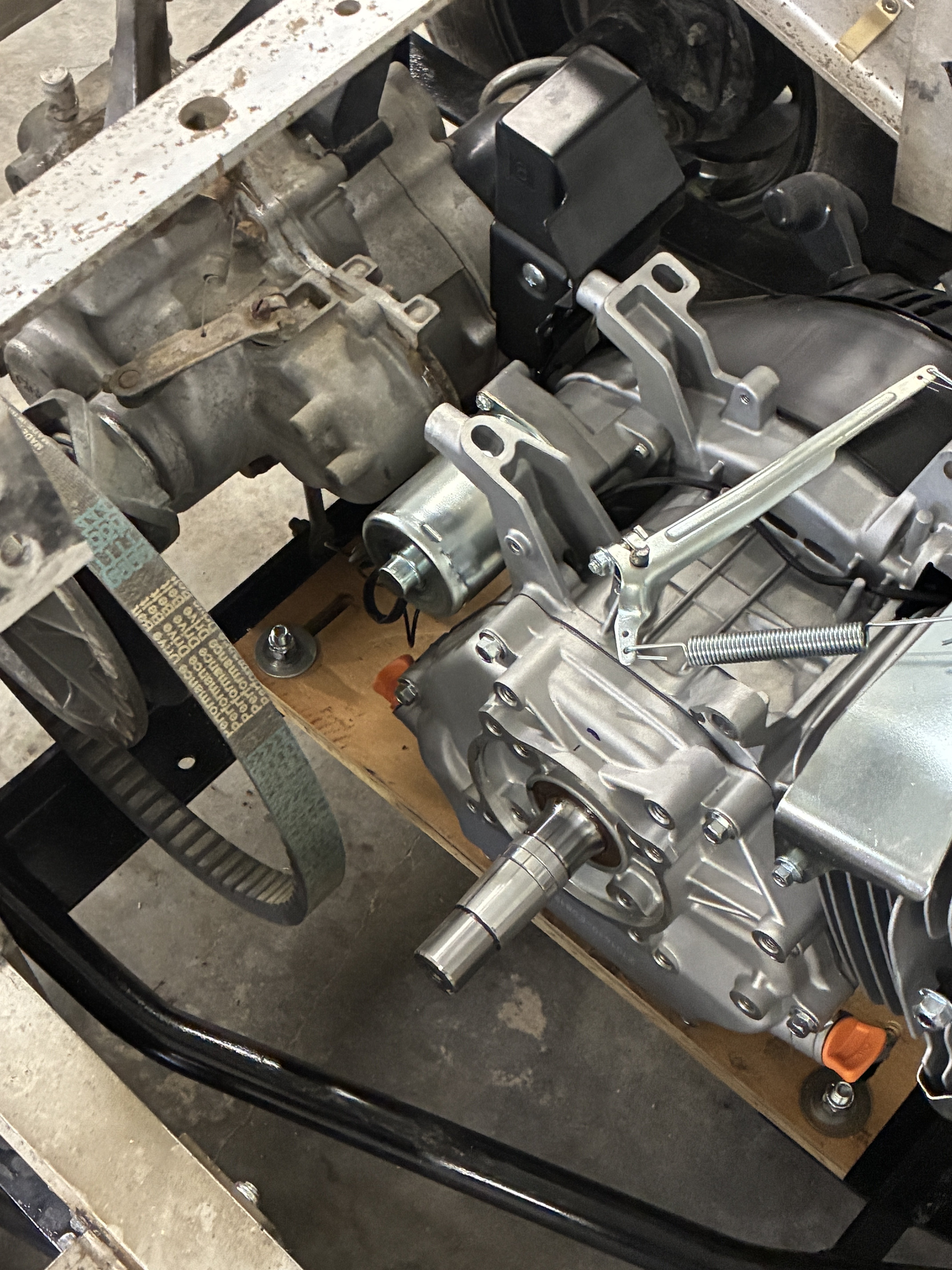

  1. Today was mount the starter generator day. The frame I was going to use has 6mm tapped holes so I drilled and tapped them to a more robust 5/16-18. I made an adapter and bolted it in place. I hung the starter and checked the belt alignment. It was a little off so I milled slots in the original bracket to make it adjustable. I’m ready to drop the motor back into the cart and finalize the location on the motor mount plate and get the primary clutch lined up with the secondary clutch on the transaxle. It was 70 degrees today so I stopped early and played gold in the afternoon. It might snow tomorrow so I can spend the day milling the new motor mount plate

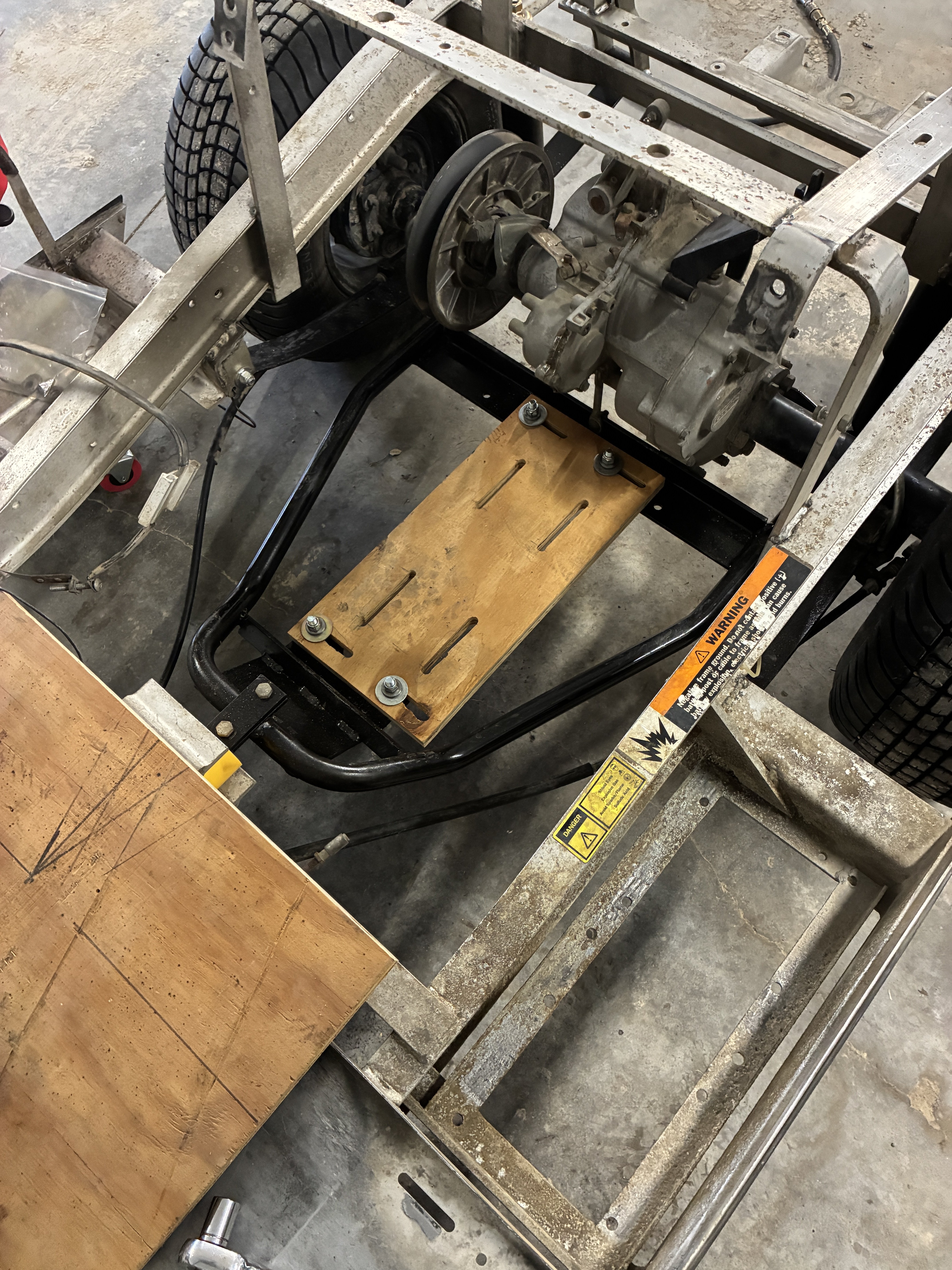

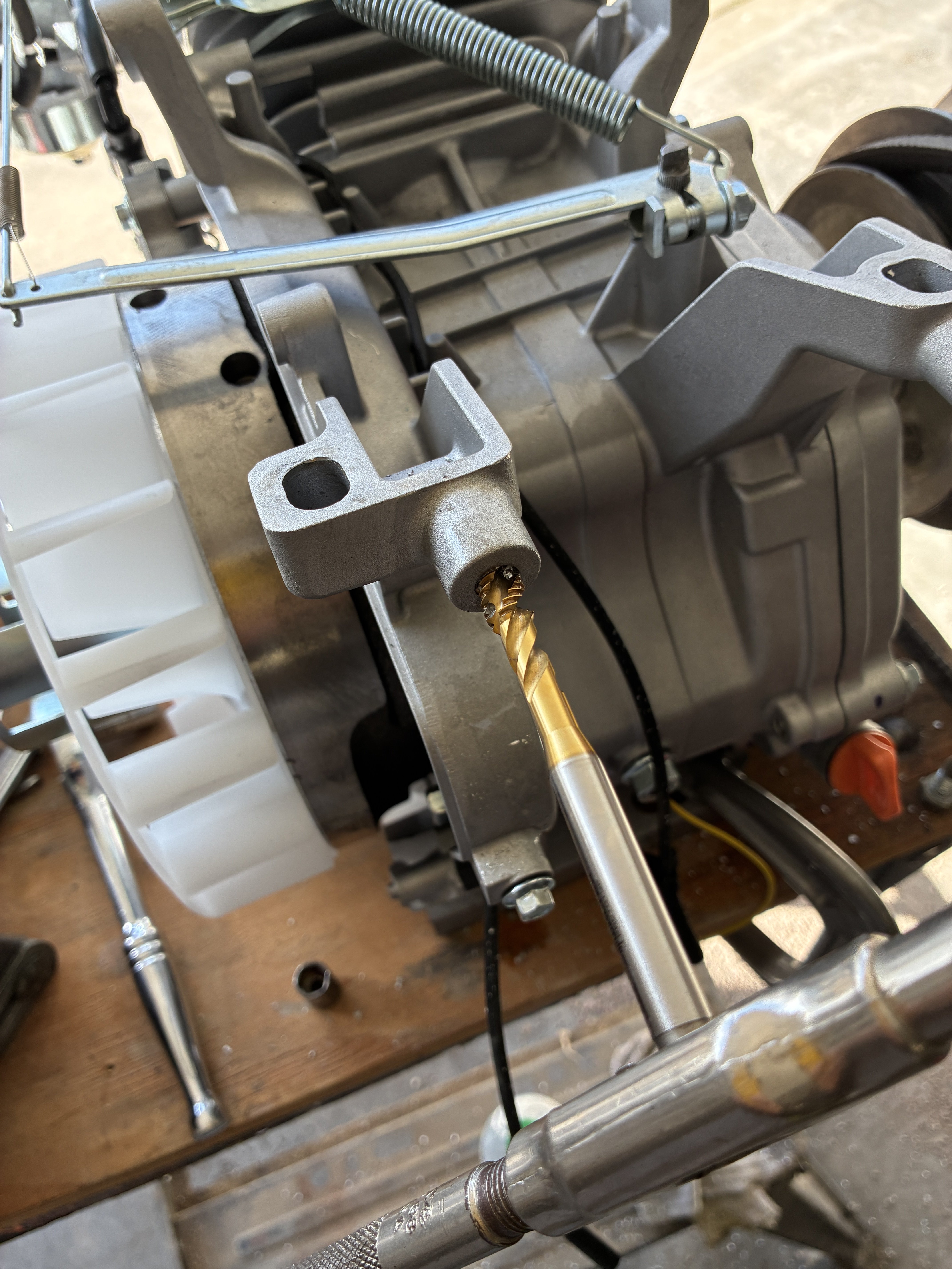

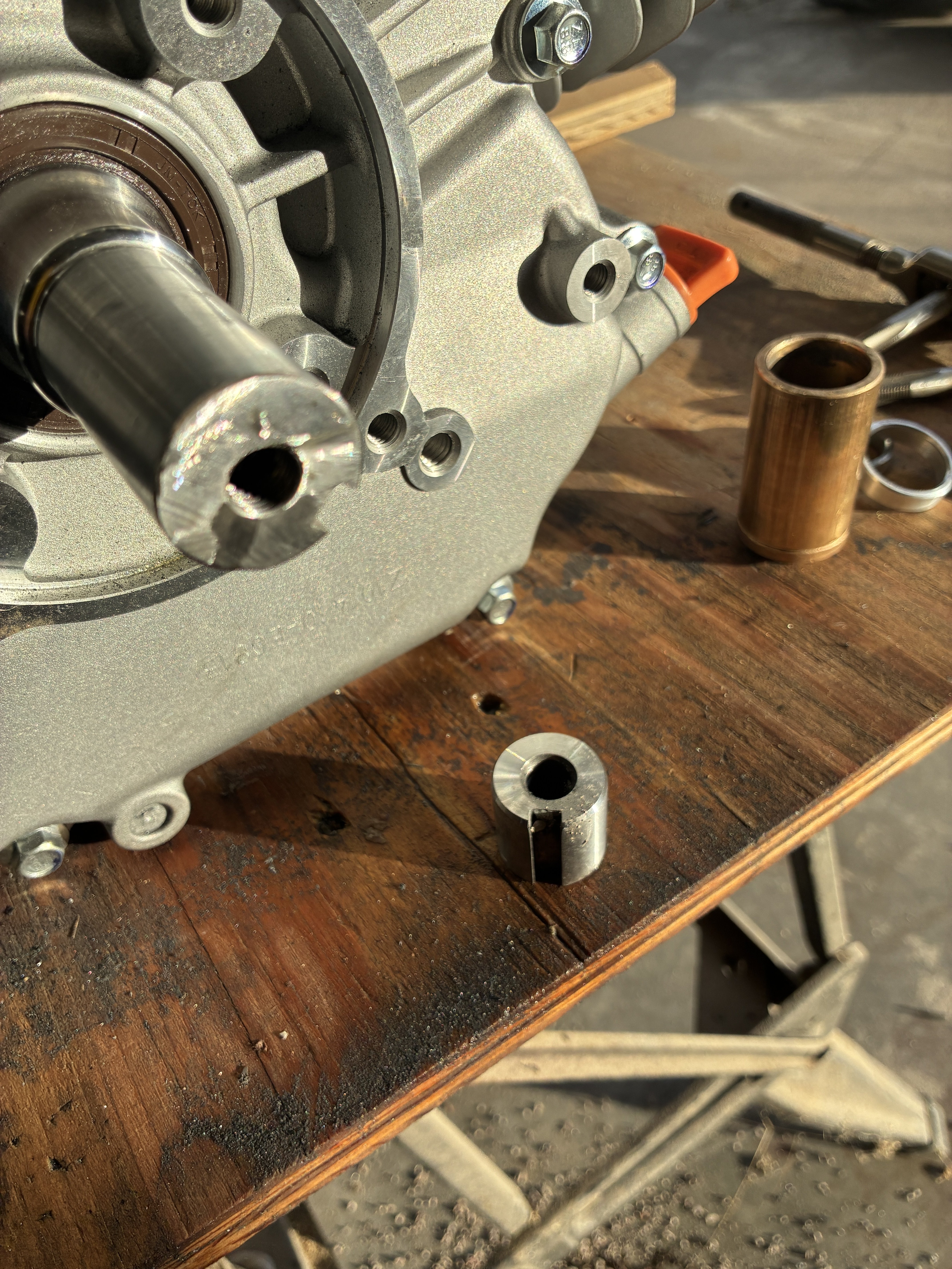

  3. I tried to use my portable bandsaw but it was too bulky and the handles were hitting the case. I gave up and cut it with a whiz wheel in my 4” angle grinder. I tapped the clutch mounting hole 1/2” deeper and replaced the taper adapter. I bolted the clutch to the crank and fired it up. It runs as true as it did on the old motor. Any runout has to be internal to the clutch. IMG_3198.mov I had the starter generator rebuilt, new brushes and the like. Now that I know where the pulley for the clutch lies, I can fab a bracket to hang the s/g inline with it. Getting close to being ready to machine a new engine mount plate.

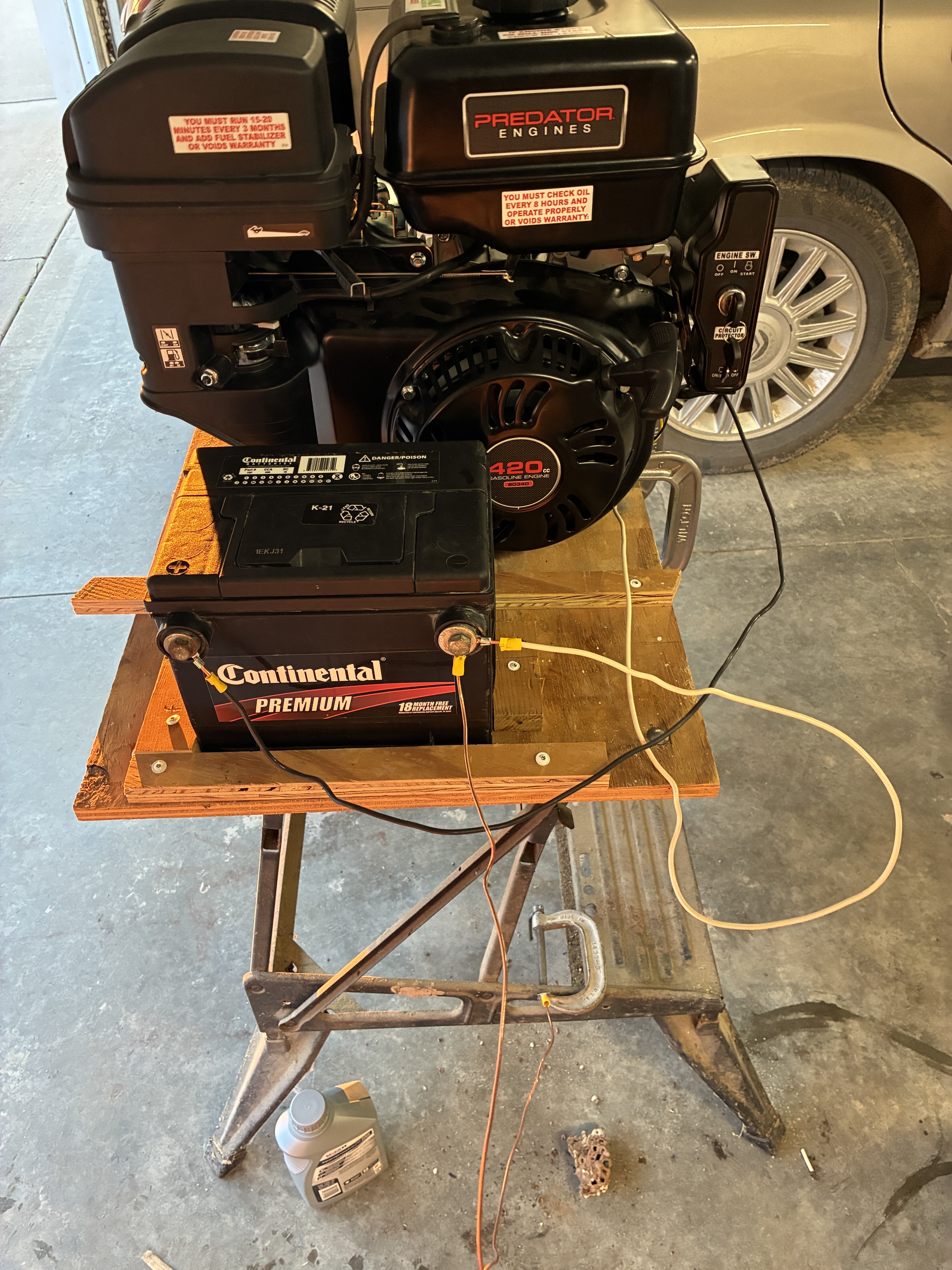

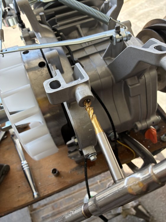

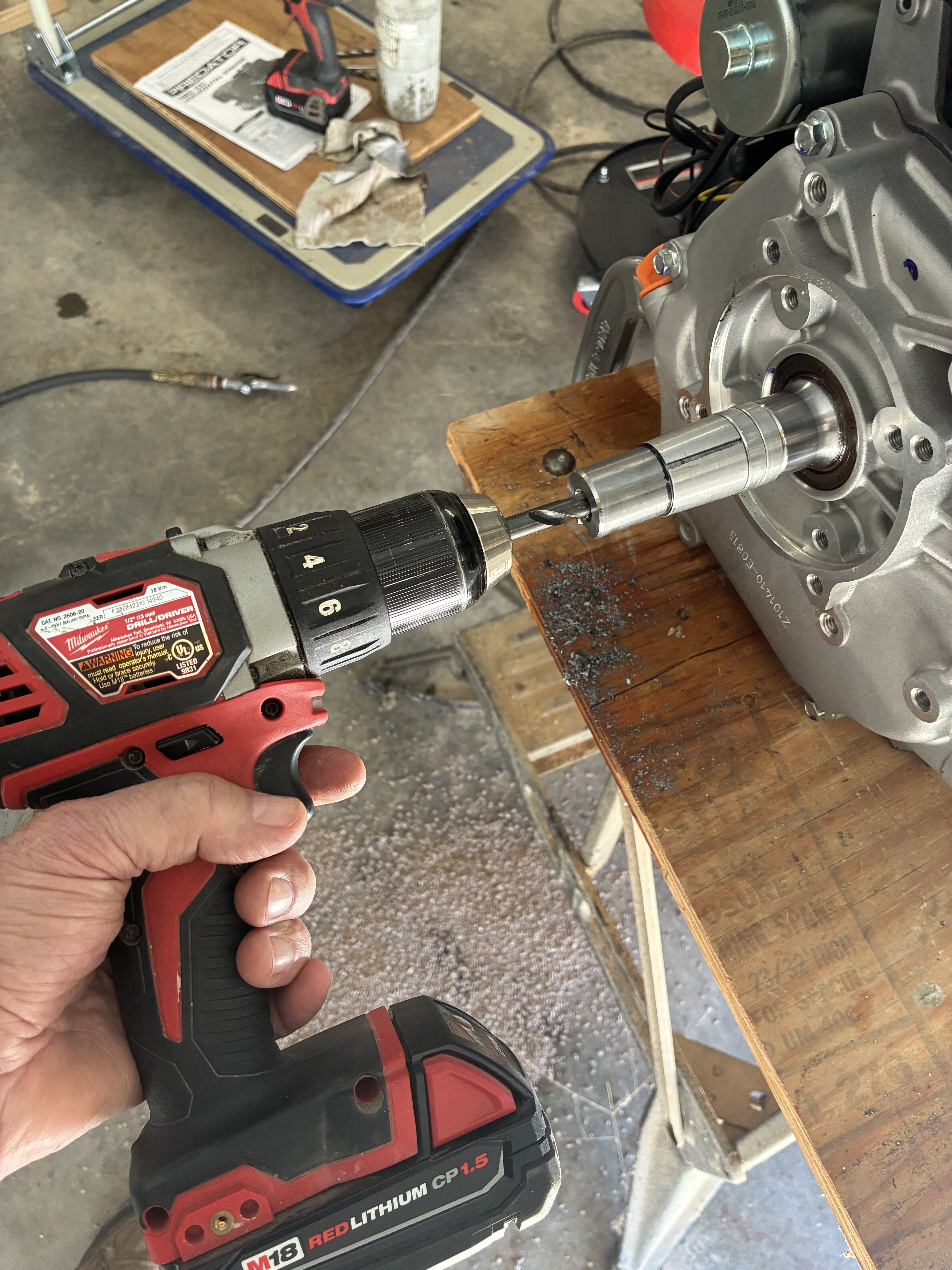

  6. I Put oil in the motor and went thru the break-in routine. I wanted to make sure I didn’t have to return the motor to HF before I altered the crank. I drilled the clutch bolt hole deeper and will saw it to length tomorrow. IMG_3188.mov

  8. The new rubber products are coming in and I replaced the body to check for starter generator clearance. Looks like I can raise the motor mount about 3”. That will also give me more room to route the new header and exhaust.

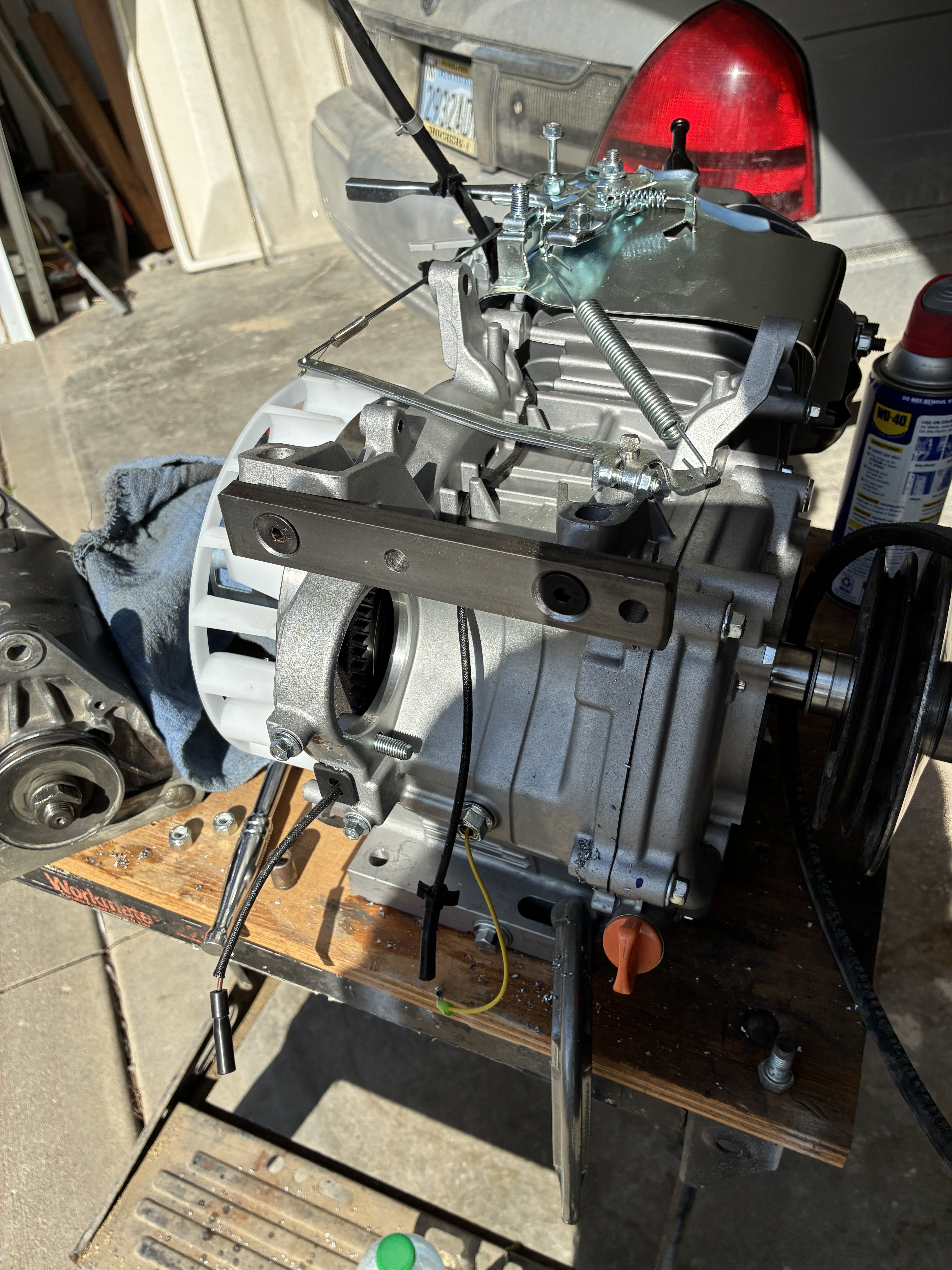

  9. I made a plywood motor mount to figure out the machining for the final plate. I need to shorten the crankshaft back to the taper adapter. I have a portable bandsaw that should make short work of that.

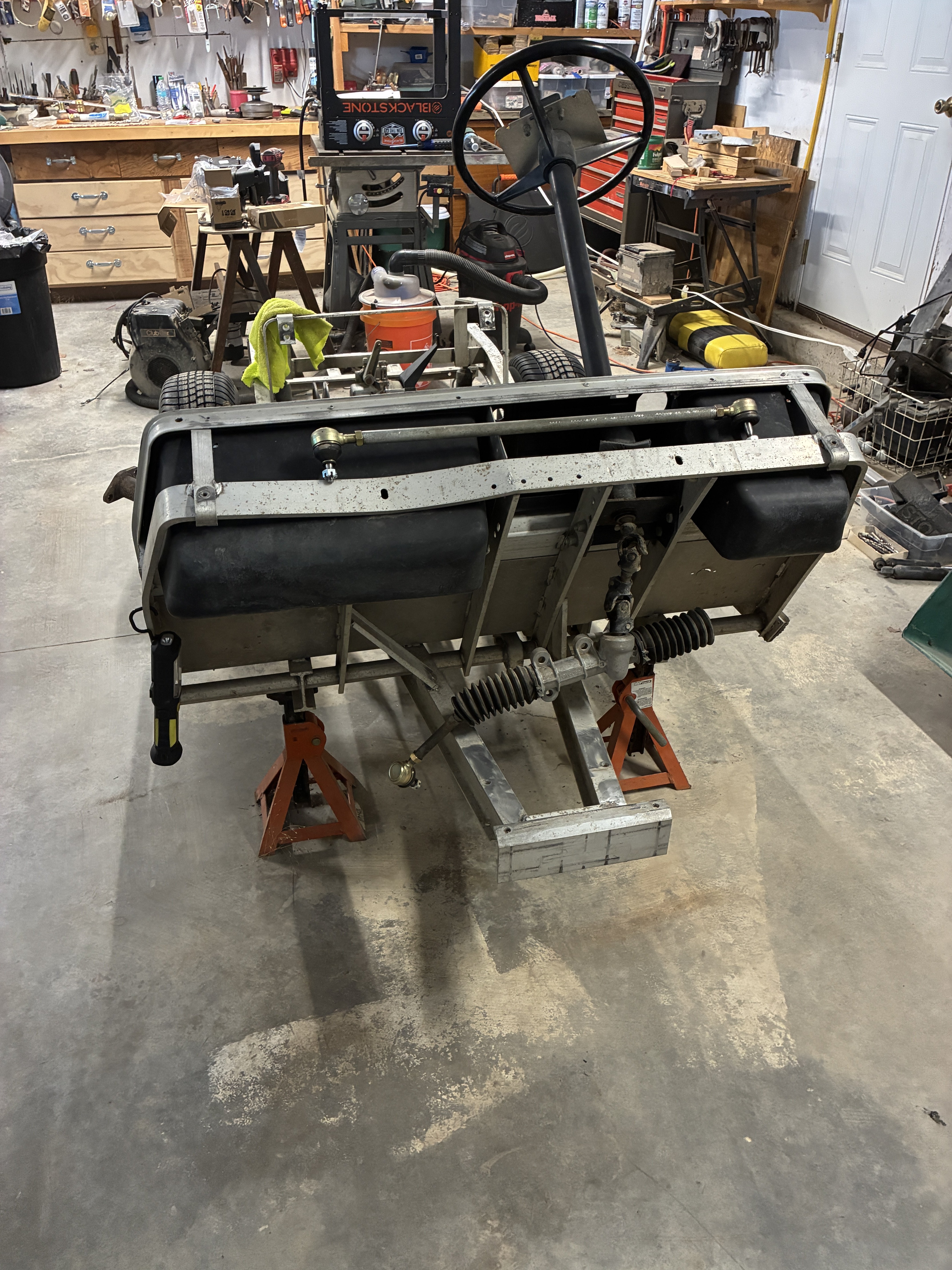

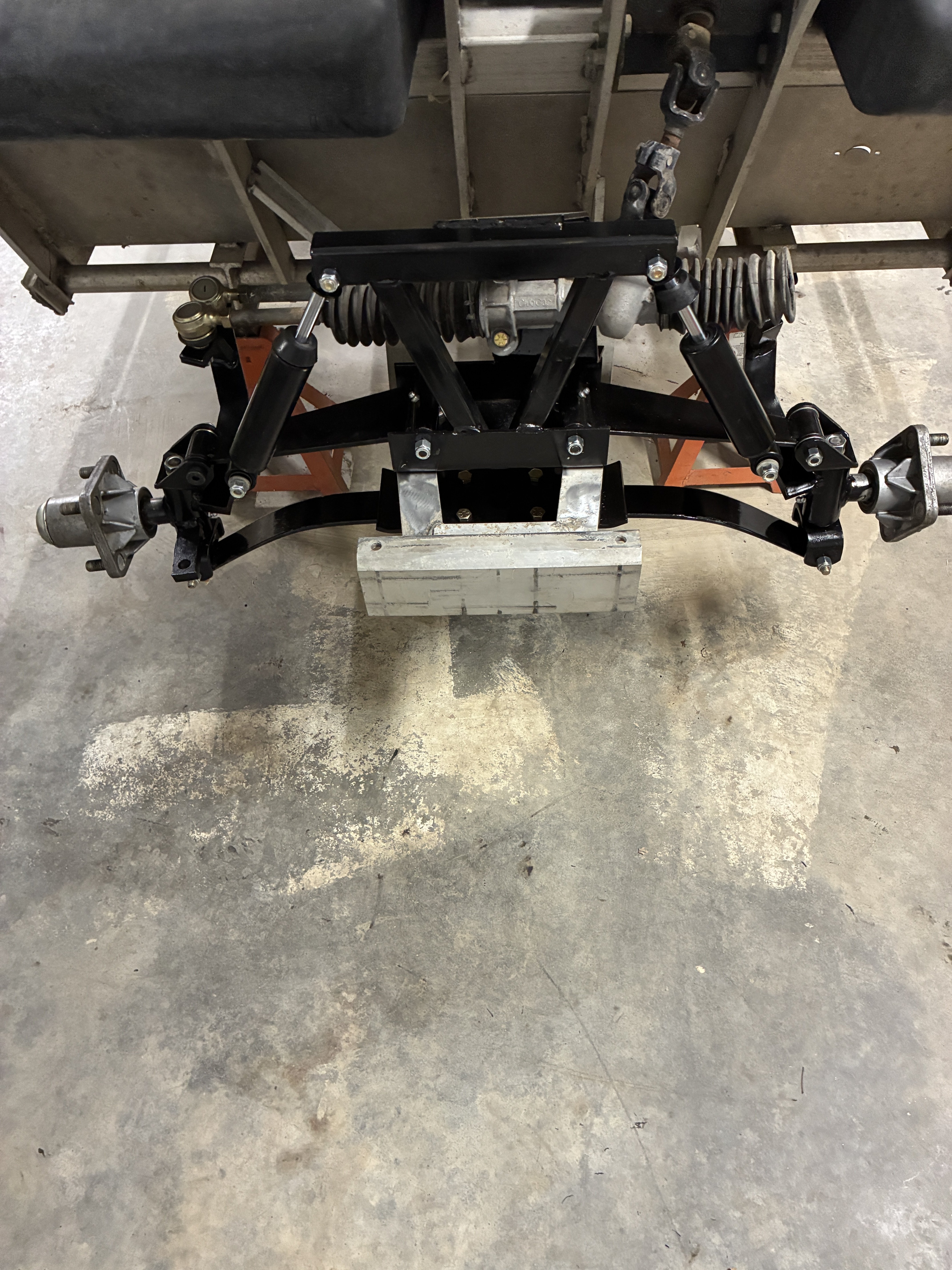

  10. I bought new shocks and bushings for both ends. A little paint and it’s nice and tight.
