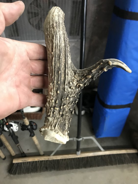

  1. nice. after you sand that down to what you like, heat to 1475 or so and quench. it should be hard. good luck on the hidden tang. i recommend a whitetail base horn. that would be cool. something like this cut down and drilled out.
