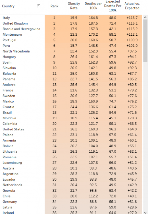

  12. In terms of actual Covid deaths vs. expected based off of obesity rates, we are 21st worst out of 160 countries. Based on obesity rate, expected deaths 96 per 100,000. We ended up at 160 per. If we tracked with the expected, we'd have had around 200,000 fewer Covid deaths than we have.

  23. It's weird because I swear there's a poster here who lives in Prague and was saying that they were doing really well early on, even re-opening faster than us based on there being almost zero community spread. But that was pretty early in the whole thing. They have the second worst death rate of any country besides San Marino. Also, that obesity rate for the Czech Republic is off, the data didn't copy and paste cleanly from the web. Thought I caught all the ones that were off. Czech is not the fattest country on Earth by 2x. Their death rate is terrible though.

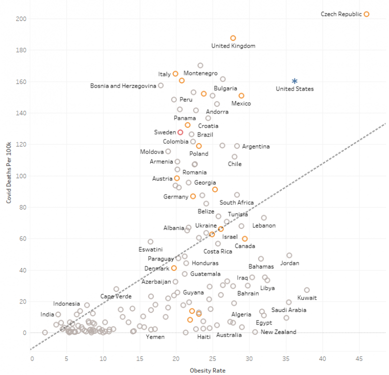

  24. Death Rate actual vs. expected based on obesity rates. Dotted line is expected death rate (deaths per 100k people) based on obesity rate. Above the dotted line is bad. So we don't get to use obesity as our excuse. Even accounting for that, we're one of the worst performing countries in the world. The countries directly above and below us in terms of obesity rates have 14% and 25% of the deaths per capita that we have. But hey, we did better than Sweden at least.
