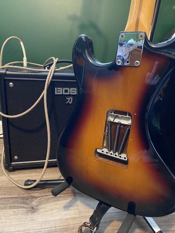

I have a dumb question: that 50s CV Strat has the tremolo completely decked. It does not move at all, and I’ve pushed down pretty hard on it. Is that only adjustable via the springs, or do the six screws in front of the saddles do something? I like my trems floating a little.

It can be both. If the screws are tightened all the way down it will hole the trem down with the springs. How was the trem decked, was the claw tightened all the way?
I .issued the back story on this Strat, but if it had a previous owner and its won't move at all they likely blocked it. Remove the back cover and see if there is a block of wood keeping the trem in place. I have one like that.
if you can't move it at all I bet AUTF is right and there's an actual block in there.

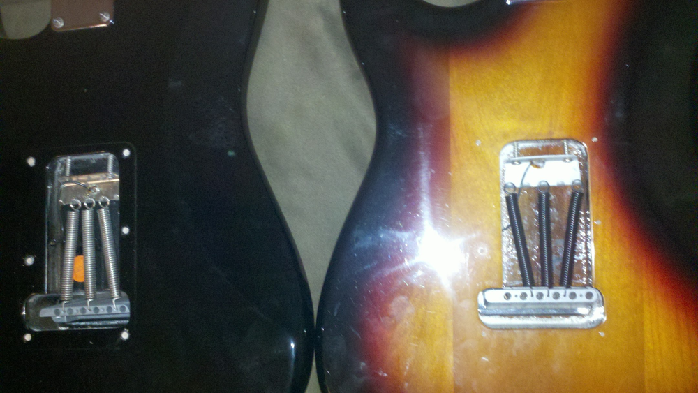

Here's a picture from 11 years ago that I took for an earlier version of this thread, probably talking about the slimmer bridge piece for my ~2001 mim strat vs my sunburst 98 American Standard. But also if you examine closely you can see that the piece attached to the body with two screws that the springs attach to opposite of the tremolo - it's closer to the body on the sunburst than it is on the black strat. My guitar teacher adjusted that with a screwdriver to anchor my trem when I was teenager, that's another way you can adjust it. I've always meant to get two more springs so I can be cool like SRV, but never have.
also I’ve been playing this without a back cover for at least 11 years and no problems yet

Good thought but it’s not blocked. I blocked the Floyd Rose on that old Yamaha baritone I used to have to so I’m familiar with that process. And I pulled the cover off of the back (I’m not a fan of those anyway) and there’s no block.
The springs don’t look to be tightened all the way so I’ll take a look at the screws in front of the saddles.

That's the claw I was referencing. I typically deck mine by tightening the claw and then tightening the pivot screws on top. On my plus I also locked the Hipshot down at the decked height.
