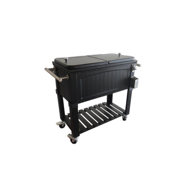

I'm taking a shitty metal rolling beer cooler that the GF bought at TJ Maxx and adding insulation and boxing it out with Cedar.
  • Started with this:  prod_12283890012?hei=520&wid=520&op_shar
Cheap quality, rusts, doesn't hold ice for shit
