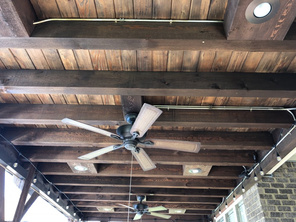

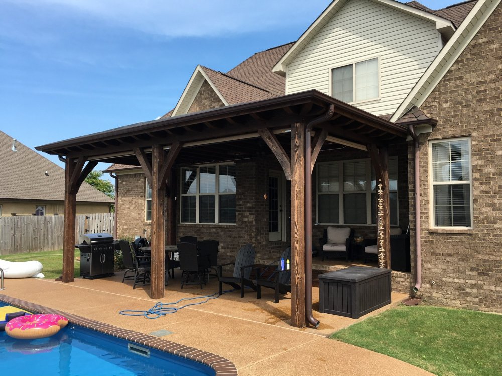

This is what we did, pictures aren’t close up on it but it gives you an idea. This one is 30x14 and we put in pine tongue in groove ceiling, recessed lights in boxes, fans, power outlets, full roof and gutters, and roll down blinds. It gets significantly more use than if we would have put in a pergola because we can use it mid day and in the afternoon sun.
Flat pitch roof? Who built it?

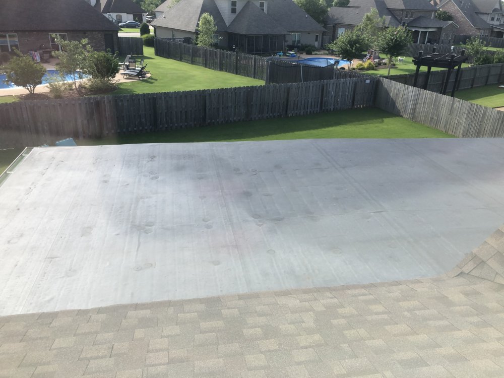

No, the roof has a slope from the middle our to the sides. They used some composite material (not sure what) to create a slope from the center out to both sides. Then it has a rubber membrane over the top of that. A local wood guy did it, but I’m a good ways from most of you guys.

That was actually a question I had.  Do you mind sharing what you paid for it?  Maybe it's the angle, but it looks smaller than 30'.  I actually went out to measure mine to reconfirm and it definitely is ~~32' x 15'.  Anything you would have changed after-the-fact?  If I go gabled roof, I think it would need to have more of a pitch so that it doesn't look funny w/ the surrounding roof design/structure.

The coverage area is a little less than 30 feet, the outside post edge to post edge is probably in the 25 range. Here Is a picture looking up as well as one of the material on top. You can’t see the pitch very well, but it is pitched from the center out. I’ve probably got about $18k-$20k or so in it, but I had it put on it’s own breaker so it is wired for the fans, recessed lights on a dimmer, and multiple plugs. The boxed in roll down blinds you can see in the picture behind the hanging lights were also not cheap. I don’t think I would change anything if we did it again. Battling the carpenter bees is a pain in the ass, but other than that it has been solid.
There are tall planters at the base of each post now. If it’s windy we just roll them down behind them where they are butted up against the post behind the planter. The braces on the posts also help keep them from flying around. We usually just don’t roll them down if the wind is blowing very much, so we don’t have to worry about it. They generally only get rolled down when we’re eating out there or hanging out and the sun is on that side of the house. I’ve seen others that snap into a base that would be mounted on the posts as well.

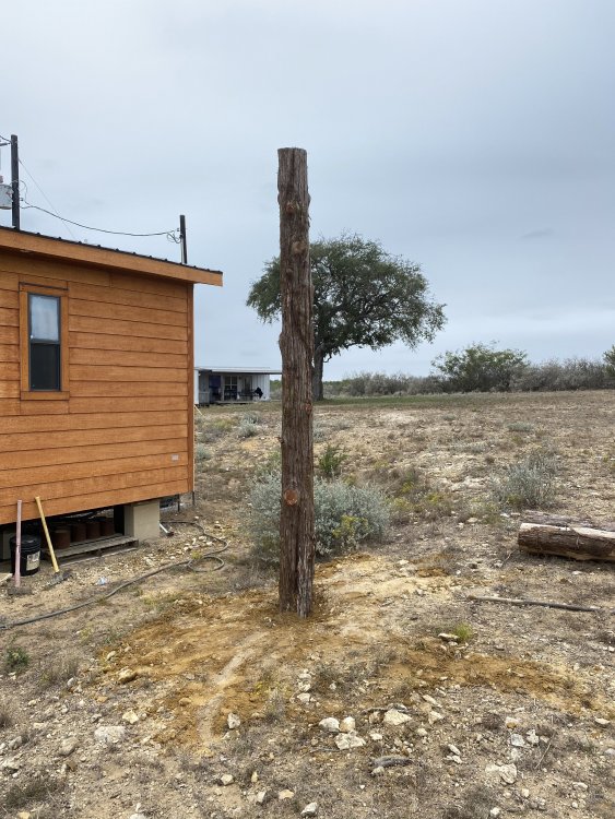

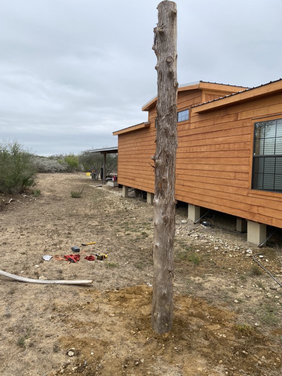

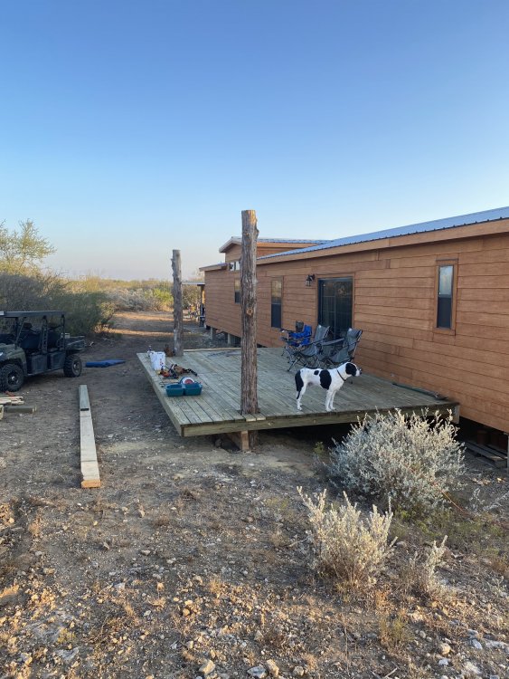

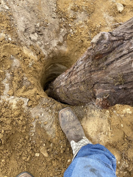

Rough cedar posts.  Heavy, Non-rotting mofos.   Didn’t use concrete.   Just dug with an auger on a tractor, hole cleaned with a post hole digger, post set and plumbed, back filled hole and tamped in back fill with a piece of rebar and a 2x4.   Moisture from rain set the soil back to near concrete form.
