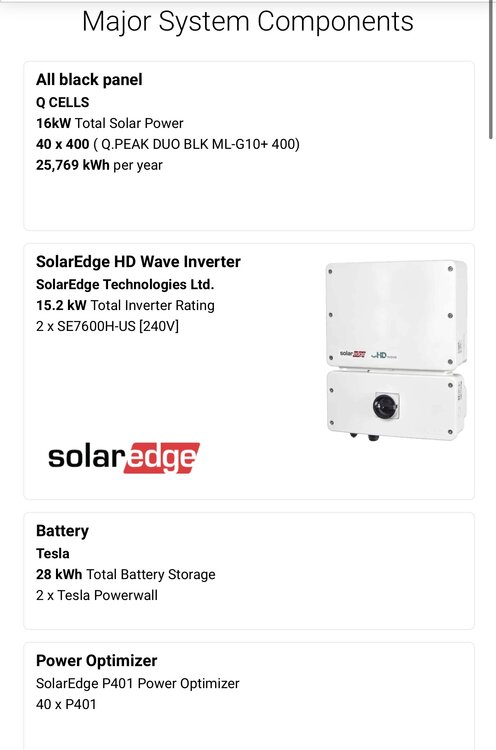

Our system for the math experts.
it is generating about 70 kWh per day on sunny days so that math is right. Backup is reduced by 10% in terms of usable power. So more like 24-25 kWh. I think they are 12 kWh usable each.

Just curious (if you are willing to share), what is the ballpark total price of a system like that, including installation?  Or half of a system that size? I've been a GreenChoice subscriber for 20 years and liked the idea of pooling money to buy wind or build solar arrays, where they could be moved with the sun.  Then Austin Energy left me in the dark for a week.  Now I don't trust the grid because of 2021 and I don't trust AE because of 2023.
I'm don't need a system as big as yours, but I could get by on half of it.  That would allow me to limp along on battery/solar during a power outage.  Not power everything, but enough to heat or cool part of the house, keep the lights on, keep the fridge going, etc.
Thank you. It’s super fun to watch the app. The price for us is in the powerwalls they are not cheap. Those come in around $30-35k for 2 installed. We are only on day 3 of use but for a spring or fall day we do seem over powered. I’d be shocked if we don’t net out at zero or even negative on a calendar year basis.
I think our exposure is extreme cold or ice and lots of cloud cover. Without sun, the batteries are probably 2-3 days of power with extreme conservation.  Unreal that this system still might not be enough for the ice storm this year or the winter blast a few years back.  For that we are just going to have to see what happens.
