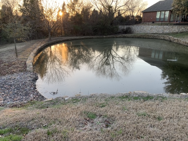

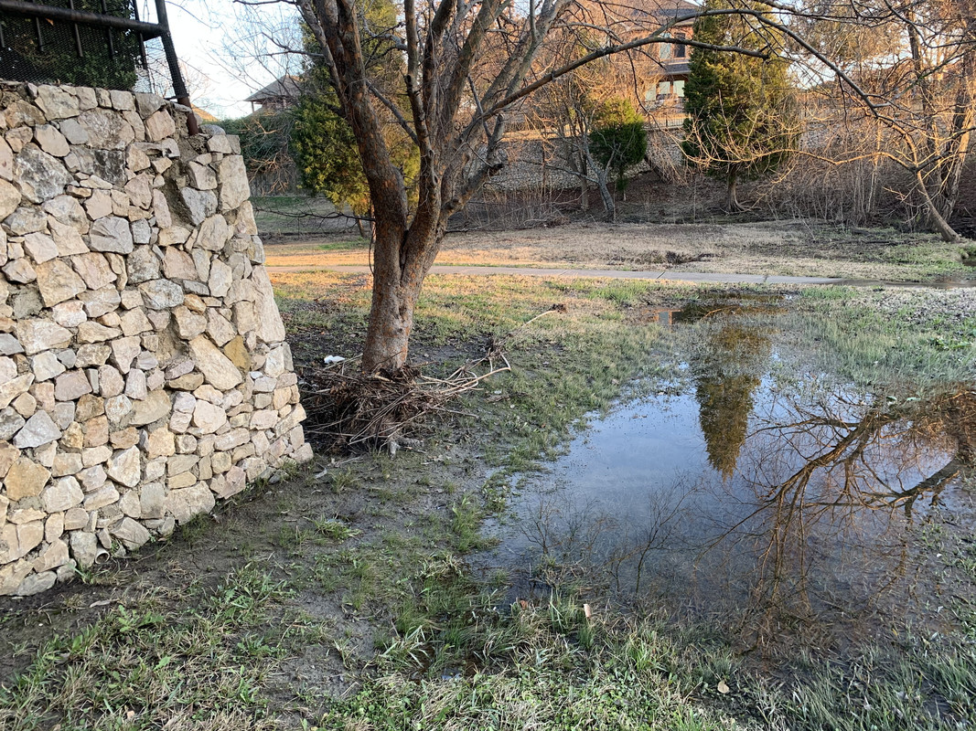

Looking for some advice about how to deal with the HOA and a possible drainage issue causing my retaining wall to fail.  So I have included pics of the pond, spillway and wall.  What is not shown, is that there are 3 more small ponds that feed into the large pond . When it rains, all the water from the top of the neighborhood drains down the hill into the 3 small ponds and  then into the big pond (pictured.)  All the extra water spills over and down a small creek in the green space behind my house.  During moderate to heavy rain, the water coming off the spillway flows against the corner of the wall.  Also, the house is about 15 years old.

You can see debris from the latest rain at the bottom of the tree, next to the corner of the wall.

Looks like the wall is a structural retaining wall and is failing due to the runoff and or lack of design on your wall. Water drainage areas like that are common in neighborhoods but should not cause wall failures.

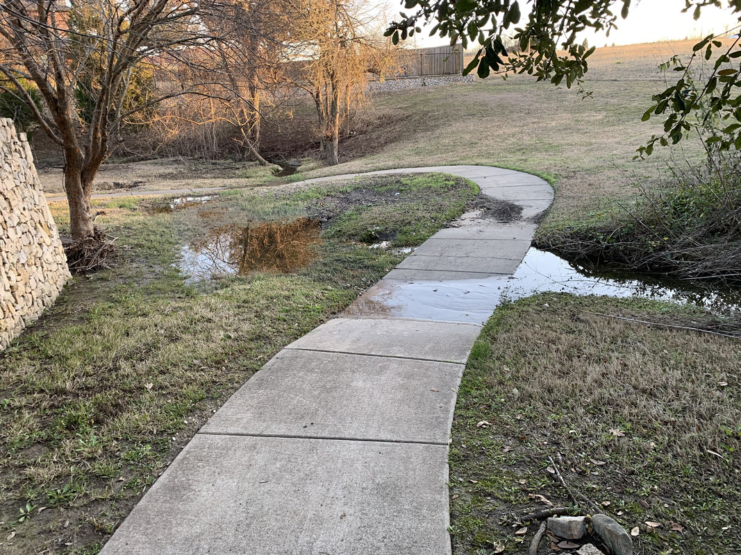

Zero expertise in this area but it seems like they did a great job of a runoff channel down the hill but fell short of continuing the channel to the creek further down the hill. Water run-off  shouldn't just block a sidewalk and create a swamp.   Couldn't there be some drainage pipe added just before the sidewalk and then over to the creek?  That would seem to be a relatively cheap solution that should handle the vast majority of rain situations?   Creates a nice safe and clean walkway for the residents.
