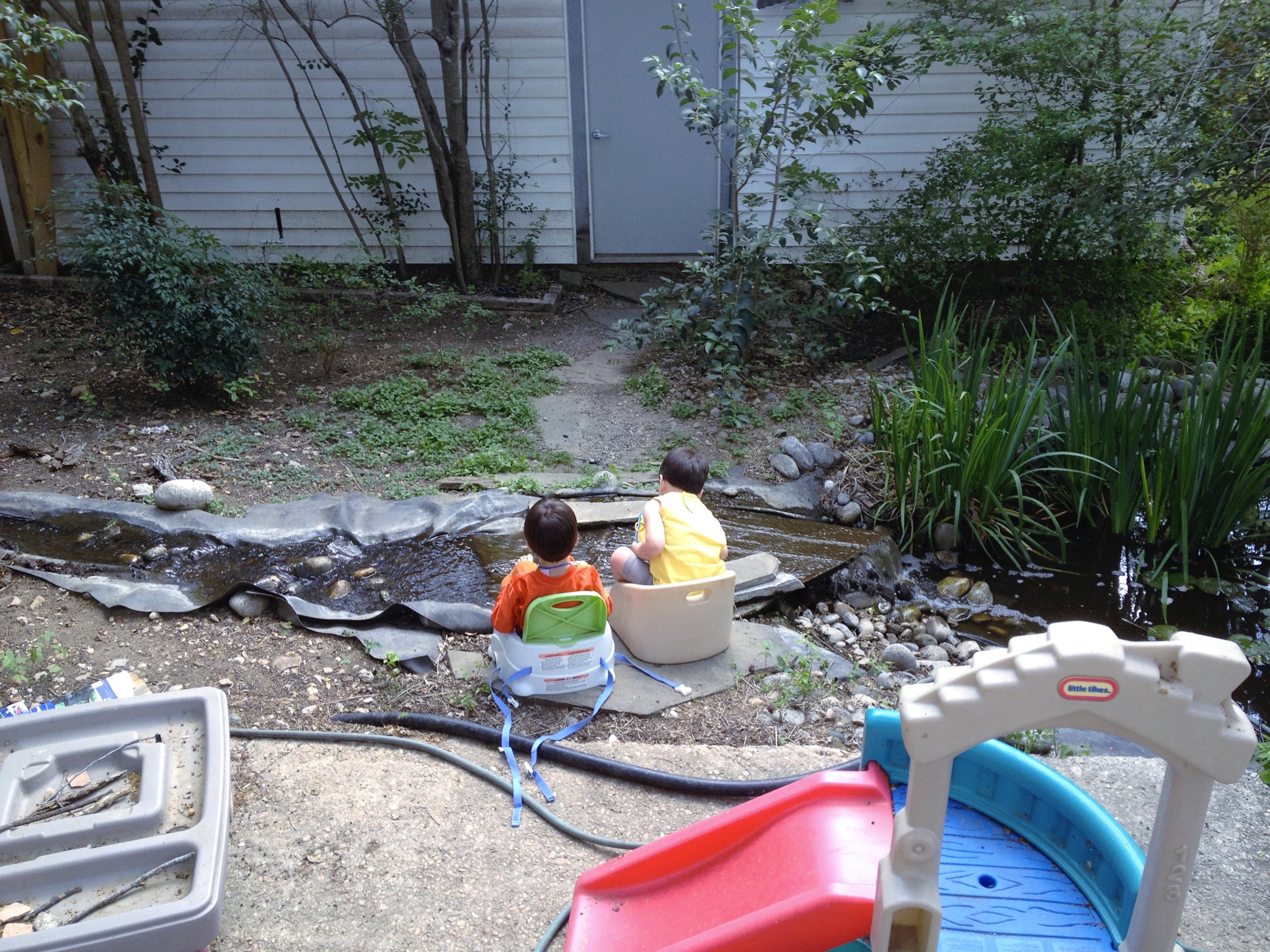

You can see my "creek" in this picture before I put rocks on top of it
The day before this picture was taken I heard the boy in the yellow come inside from the back yard and was running around the house yelling "FUCK FUCK FUCK FUCK FUCK FUCK FUCK FUCK FUCK"
I hear him go into the bathroom where my wife was and yell "FUCK" and then hear her scream and fall down. I rush to the bathroom and wife is on the floor and boy holds out his hand to me and says "Look at my fuck" and there's a tiny little frog in his hand.
I tell him we should take him and put him back in the pond. So we put him on a lily pad and he hung out for a while before swimming off. Boy started crying because his pet frog ran off. He spent the better part of the next several  days sitting out next to the pond waiting for his Fuck to come back. His brother joined him right before I took this picture.
