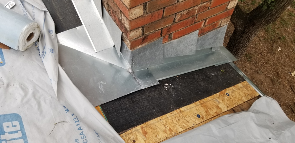

We just put on a new roof for @Felix last week & he went with the Atlas Pinnacle Pewter... plus did some new metal work on his chimney.  (see pic).  In around 2 weeks, we're doing a Georgetown project & this customer is going with Owens Corning TruDef Duration Sierra Gray.

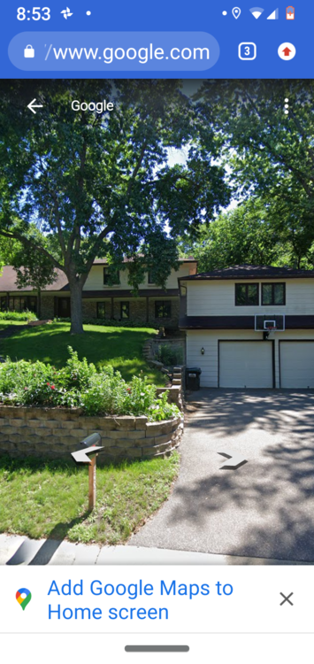

Here's the damn house. It's kind of a cream with brown edging and gutters. Feel free to photoshop dicks on it but I draw the line at any virtual sooner logo graffiti.  We live in a society, damn it.
