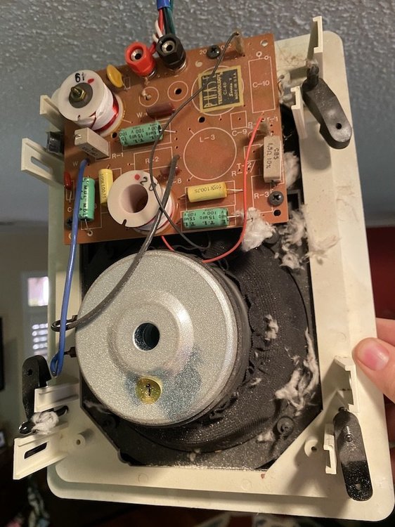

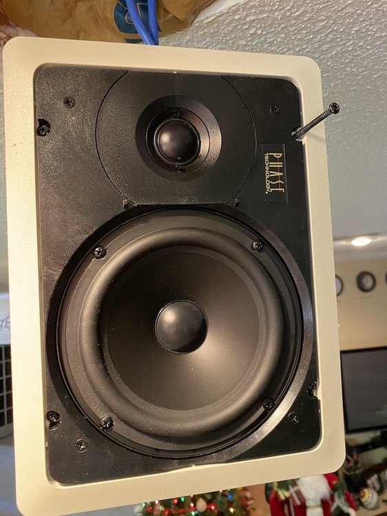

I bought a house that had speakers installed in the ceiling in a few different rooms. I bought some cheap Pyle receivers from Amazon to hook the speakers to and then plugged Amazon Echo Dots into each receiver. The Alexa app on my phone lets me set up groups and stream music all over the place. I’m pretty pleased with the outcome and each setup was about $60-$70.

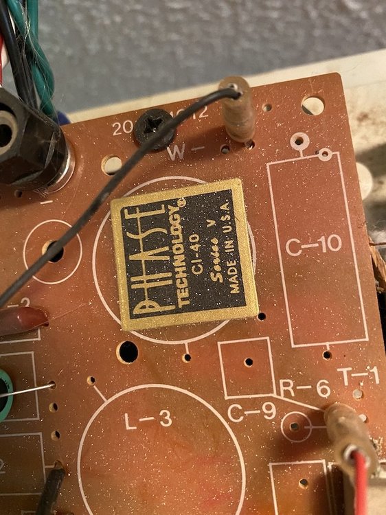

So I checked out my ceiling-mounted speakers. Here is what I found.
Phase Technology CI-40
They are all over my house. Two in living room, two in master bath, two In master bedroom, two in office, two in dining room, two on patio.
I would really want to connect only the ones in the living room.  I have located the wires behind a face plate by the fireplace. Can I just buy a receiver as Buzzrock mentions above and plug these in?  What about the circuitry on the backs of the speakers?

I can’t speak to the circuitry question but yeah, any stereo amp/receiver ought to drive them. A quick Google shows that those might be some pretty decent speakers. I popped the covers on mine and they are Polk Audios
If you have trouble figuring out which wires are which on the other end, you can touch the wires to a AA battery. If you hear a soft popping coming from the speaker you know you have the right pair.
The circuitry on the back is the crossover that splits the signal between woofer and tweeter, leave it alone. All you need to do is connect your chosen receiver's speaker out + and -  to those red and black terminals at the top of your first photo.
Phase was a solid brand back in the day, almost high-end.
