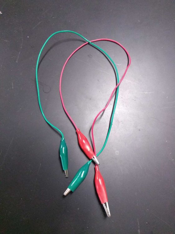

Since the wires are already fucked, just cut and strip them and run jumpers between them to see if it solves your problem.  You have to fix them either way, so you might as well figure out if that's your problem before you go any further.
Expand
I was planning on doing that as soon as I get some free time. Probably this weekend.
