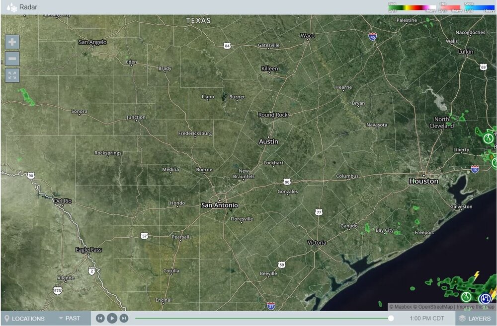

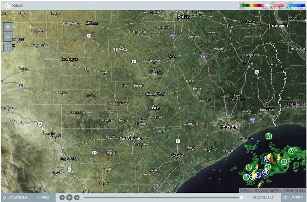

Can anyone confirm if there is rain at the track currently?
Getting steady drizzle in NW Austin.
Nothing on radar except some stuff in the gulf.
Concur.
Was drizzling and cool earlier and track was damp but fog/clouds are breaking now and temps getting into the high 70s, low 80s.
