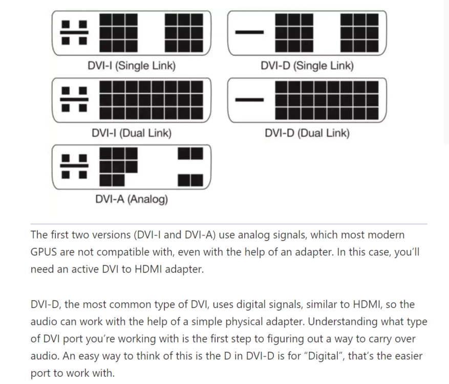

Yeah, not true for all DVI connections. DVI-D carries audio.
Edited by rage-a-holic
Thanks.
He's actually using an HDMI cable, so it's not a DVI issue, per se.  But as that post notes, Windows is recognizing it as a "dumb" form of monitor and so apparently is not putting the audio on the HDMI.
