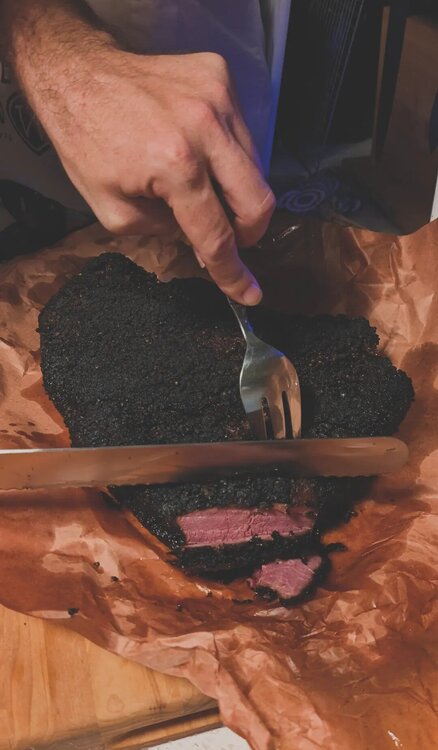

2nd attempt at a pastrami brisket last weekend. Used a prime brisket from Costco and cured it for 14 days...only did 7 last time and that wasn't long enough. Made the Katz dry rub, smoked to 175 then steamed in the oven to 203. Previous time I didn't steam it, definitely like the texture more after steaming but it obviously softens the bark. Overall thought it was really damned good.

Bravo! I love pastrami and this looks fantastic. It’s hard to find deli pastrami with enough smoke and bbq joint pastrami with the right spice and texture. Yours looks great!

That looks really good.  I know steaming is traditional, but I've really enjoyed the bark on my pastrami when I've just cooked it straight through.  Do you think a shorter steam would preserve the bark.  Or maybe steam to 195F with a quick trip back to the smoker to firm it up, kind of like wrapping ribs?
I think any amount steam is going to soften up the bark. Definitely worth experimenting with firming it back up after the steam. I could see blasting it under the broiler for a couple minutes working, or maybe a trip back to the smoker.
