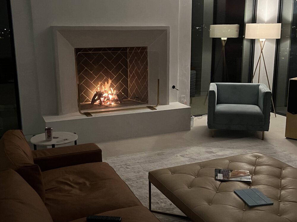

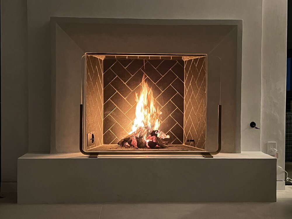

We’re back!!  It’s been 3 years since my last proper fire. Art not up yet some finer decor points still lacking but we have FIRE!!!  No peeing on it allowed in the new house.
Edited by troph

No. It came with the 22 year old house that we bought 2 years ago, so the $6k figure I posted was rather deceiving. I was referring to replacement cost. We're actually going to move it to the next wall over so that it doesn't block our view of the ocean.  I don't know where the PNW architects learned their trade, but they've got some interesting ideas...
Edited by otisdog
Really nice Troph.  Well done.
