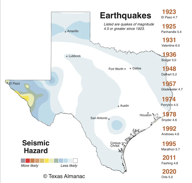

Like has been mentioned many times already the quakes are being caused by the huge volumes of water being disposed into deeper reservoirs that contain dormant fault systems. If the disposal wells are injecting into the deeper horizons they run the risk of being in area where these deeper horizons are located in a fault system area.  Not all deep disposal is located in faulted areas.  As a result of the increased pressure and possible "lubrication" from water disposal some of these dormant fault systems can be slightly reactivated resulting in the earthquakes being seen.  This is a direct result of the exponential increase in production of oil, gas and water from horizontal drilling, mostly from shale reservoirs, that has taken place in the last 5+ years. And yes these wells have to be fraced to produce in commercial quantities. It’s really a large scale manufacturing process now.
The water disposal issue is a very hot topic now and is being studied in depth. I think we will see less and less earthquakes moving forward. But they won’t completely stop.
My bigger issue is the amount of water disposal taking place in medium depth horizons, which typically are not faulted. This is wreaking havoc in the oil field, causing the loss of legacy vertical wells.  Major water flows while drilling new wells and holes in casing to existing wells as a result of the huge volumes of water being disposed in an amongst existing wells, have become a real problem from my experience.

103 earthquakes in one week: What's going on in west Texas?
https://www.usatoday.com/story/news/nation/2024/07/29/west-texas-earthquakes-explained/74590224007/
So many earthquakes have struck the west Texas county of Scurry in the past week – more than 100 at last count – local officials have declared a state of emergency.
Scurry County Judge Dan Hicks wrote in his Friday declaration of disaster that since the first earthquake, registering magnitude 4.9, was felt the night of July 22, "damage has been found throughout Scurry County in businesses and residences."
103 earthquakes in eight days
From the first large quake of magnitude 4.9, the county has experienced a total of 103 earthquakes, including 12 of magnitude three or more, said Justin Rubinstein, a geophysicist with the U.S. Geological Survey in Menlo Park, California.
The rash of earthquakes is not naturally occurring, as Texas, in general, is not a very seismically active part of the country. Instead, it is"almost 99% likely" to be linked to local oil fields, Rubinstein said.
“We can say with confidence that these are related to oil and gas extractions," he said.
The temblors are very likely linked to new forms of oil and natural gas drilling technology that allow companies to drill not just down into the earth but horizontally along an oil formation.
They are reaching deeply buried oil and natural gas deposits that are the decomposed remnants of plants and animals in ancient oceans. When the oil comes up, the salt water, which can be millions of years old, also comes up.
This is called "produced water" and there's a lot of it.
"The ratio of oil to saltwater is low. It can be five or 10 or even 20 barrels of saltwater for every barrel of oil," said Rubinstein.
This prehistoric water is much saltier than ocean water and can't be disposed of in rivers or even the ocean, in part, because it can contain contaminants such as hydrocarbons.
Instead, it must be pumped back deep underground where it cannot leech into groundwater, a process called saltwater disposal.
The large amounts of water being pumped underground in turn can cause earthquakes. "We've found evidence that saltwater disposal is the most likely cause of the earthquakes in Scurry County. This specific area has seen seismic activity going back to 2020," Rubinstein said.
