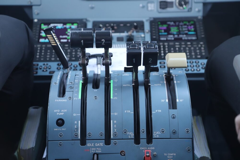

Don’t know if this works as an attachment from my phone but the prelim is out. Seems like things went a little south during the landing sequence. I don’t have any ATR time but it seems like feathering the props when they called for flaps 30 is a bad thing.
343.pdf
Edited by HiggyBaby
Done by the PM (Pilot Monitoring).   He or she literally pushed the wrong “button”.
