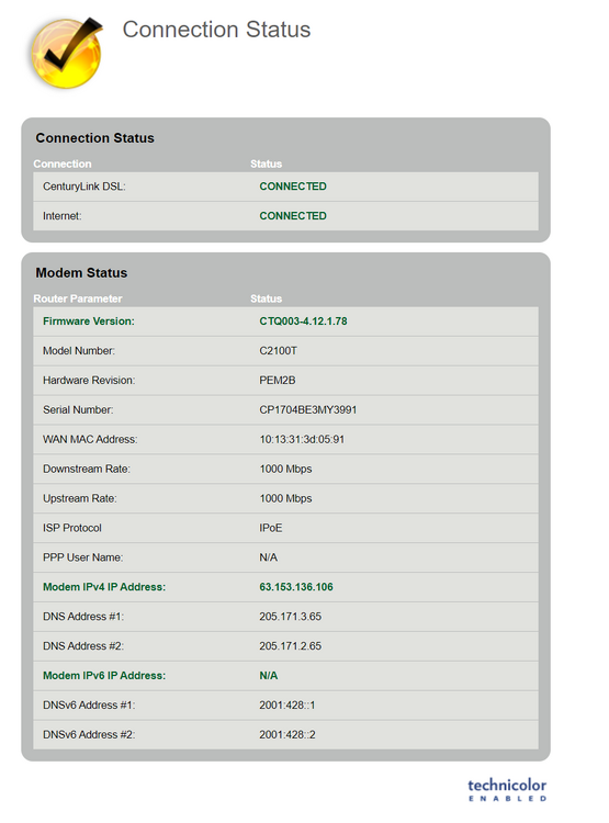

This is a screenshot of my settings/configs.  I have no idea what all this means, and I presume you aren't gonna use this to sign me up for porn or anything:

That second image is your WAN status = connection from router to the internet…we know that’s fine because wired works well.

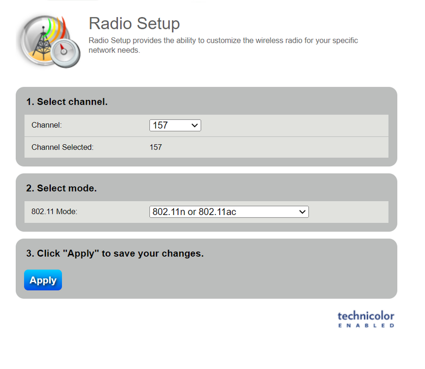

Often there’s an advanced section in the wireless config, that may need a special password from the bottom of the physical router to get.  If you get into the advanced section, try changing the ‘channel’ for it…on mine there’s an ‘auto scan’ setting that’ll look for the channel with the least interference.  If all WiFi is slow but wired is fine, likely something is conflicting with your signal…neighbors WiFi, microwave, your wife’s dildo, something.  Changing channel can resolve interference.
This?
There's an auto.  I'm there now.  Will run for awhile and check back.

Yep that’s it.  Try changing that channel a few times, or try auto first…but if auto ends up on the same channel then try manual changes.  May take a few tries, testing speed each time.
Not saying that def the answer but that’s what channels are there for, interference.
