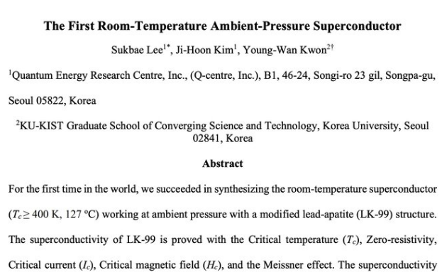

I did a little digging and was surprised to see that there hadn't been any chatter about this yet on the Surl. The science behind this is well beyond my ability to fully understand, but the potential implications if this is real could change the world as we know it. The South Korean scientists who made the discovery and posted a paper about it would almost certainly win the Nobel Prize if this is confirmed to be legit.
The quick and dirty:
Let’s look at what’s being claimed, and how strong the evidence seems to be. The authors describe a lead-based copper-doped material, LK-99, which is made by first preparing a well-characterized mineral (lanarkite, Pb2(SO4)O) from lead oxide and lead sulfate. Separately, copper phosphide (Cu3P), another well-characterized compound, is also freshly prepared from elemental copper and phosphorus. These two substances are ground together in a 1:1 ratio and the mixture is sealed in a vacuum-evacuated quartz tube and heated to 925C, forming LK-99, which is Pb10-xCux(PO4)6O, a dark polycrystalline material. The structure is very similar to lead apatite, a well-characterized phosphate mineral, but its crystallographic unit cell is slightly smaller due to the substitution of particular lead atoms in its lattice by copper ones.
And it’s this effect on the compound’s structure, the authors believe, that leads to its extraordinary superconducting behavior. Honestly, “extraordinary” doesn’t get it across. We’ve been getting excited over the years about superconducting materials that don’t even quite have to be cooled with liquid nitrogen, and this stuff is claimed to superconduct all the way up to room temperature and indeed up past the boiling point of water. Its critical temperature is said to be 127C (!) The phrase “boiling-water superconductor” is not one that I had ever used until yesterday, trust me on that.
So they claim to have discovered a superconducting material that is made from readily available materials and not Unobtanium or Vibraniaum.

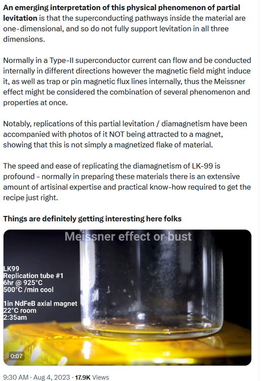

They did give good steps for reproducing their claims, and the synthesis seems pretty easy, so this will be proved or debunked in short order. So far it has not been debunked, so it might be real. If so, it will surely be a big deal. Even if this particular material is not very practical, it will be a starting point and other related materials will get tried very soon. Science at work!!!
Fyi, there is at the same time, another research group that has reported room temperature superconductivity, though at very high pressures, and that research is very dodgy, at least one paper related to that has been withdrawn due to suspected data fraud. But those issues do not apply to LK-99.
I'm not buying it until Travis Taylor and a hot university professor from a barely related field explain it to me on the history Channel.
0 for 3 so far, but it's still early days.

I spent about 20 minutes browsing the numerous threads on reddit about the topic. Reactions are all over the map and I'm too dumb to really understand whats up at this point. But the fact that the technology didn't originate in BCS and no maroon carrots are involved have me cautiously optimistic.
This US team started gathering materials for a replication attempt the first night after the paper was published and appear to have been able to generate a tiny fleck of the material in their first attempt. Evidently the original paper is very generic in some of the steps needed to synthesize the LK99; for example, these guys tried 13 different "bake" times in the furnace for one of the steps. A lot of those times generated partially synthesized materials or just straight garbage. But this one little fleck does exhibit the Meissner effect - at least on one end of the material. People a lot smarter than me are encouraged by this...
So #itshappening maybe?

So we now have 2 (I think) videos showing this material levitating or partially levitating over a magnet. Assuming those aren't hoaxes, is there any alternative scientific explanation for that phenomenon? Like, "this isn't a superconductor, but instead is XYZ, which can produce a similar levitating effect?"
Did the video look anything like this?

well from the nature article referenced above:
The limited success of the replication attempts has not quelled speculation online. Unverified videos of samples, supposedly levitating because of superconductivity, have circulated as viral evidence, despite the fact that many materials — including graphene, frogs and pliers — can exhibit similar magnetic behaviour.
