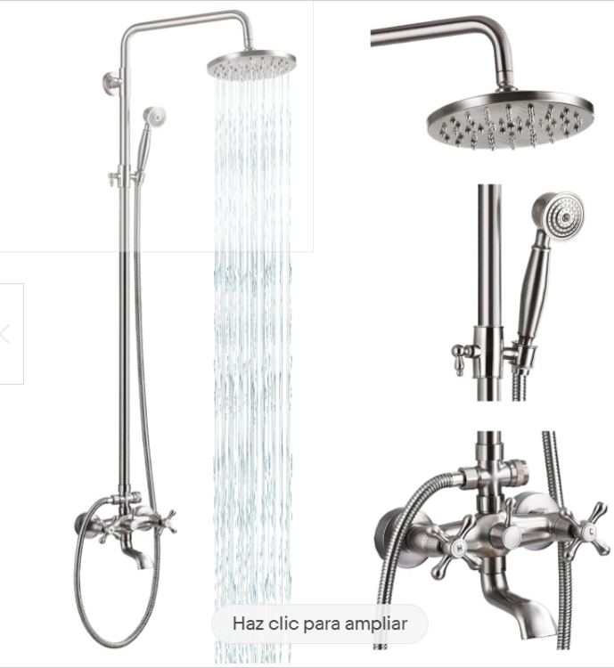

We want/need to convert it to a shower function. I’m happy to go with a switch to a tub fixture with diverter and shower head. I expect we’ll have to 1) pull all of that tile (as we understand, it’s not sealed to be waterproof) and replace the drywall with something designed to keep water out (we don’t want to skimp there - we’re an upstairs unit, don’t want to cause any headaches) and 2) close it off with either a sliding glass door or curtain.

for example
Yep. I get that. Seems to me that the plumbing is the least of our concerns (presuming that Scottish building codes aren’t all fucky, which is entirely possible). My bigger concern is waterproofing the “stall” of the shower. The tile there isn’t waterproof, and the walls above the tile sure aren’t. That seems like it should be the biggest part of the job.
