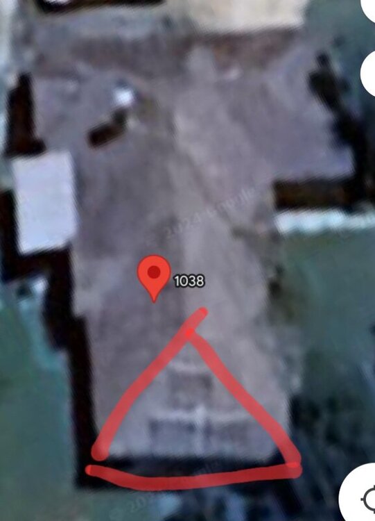

4 hours ago, Dahobbs said:
Solar panels are considered attached to the house and are generally covered by HO policies. There are sometimes exclusions for damage caused by wind or hail depending on where you live. There may also be issues getting damage covered if one didn't notify their insurer previously of the install. But I can't think of any reason that an insurer would refuse to cover a house entirely. I think that is misinformation and may even be against the law. Finally, if the roof is damaged enough to be replaced, I don't see how removing the panels is really any extra labor. Reinstalling, sure.
We are doing a re-roof soon & Farmers IS paying $ 6,000+ for the PV panel D&R (Detach & Replace).
One end of the house & not a large array.  Removal is specialty work & unless you know what you're doing to disconnect from the electricity components, that's a dangerous thing.  Nobody on my crew would do anything other than to clean a panel while it is on the roof. .
Pic attached is the best Google Mapolator has & I don't have house photos on my phone any longer.
I'm trying to find a reason why they will not pay for panel D&R If they are not damaged & can only assume because insurance wanted advance notice so they could attach a rider to accomodate costs for possible D&R or even full R&R (the recent Dripping Springs hail we had out here completely destroyed 8 panels on a house we ate working with & that's being covered completely by their insurance as a total loss inclusive to the shingles).
Yeah, fair, normally the solar company would handle removal of the panels. Still, my understanding is that the majority of any additional work is on the re-install and not the removal. I think your assumption makes sense regarding failure to provide notice of the panels. I'll note, if the panels were destroyed by hail, it would be worthwhile for the homeowner to look at the manufacturing warranty. If the panels were rated for above that level of hail, they likely have a warranty claim.
