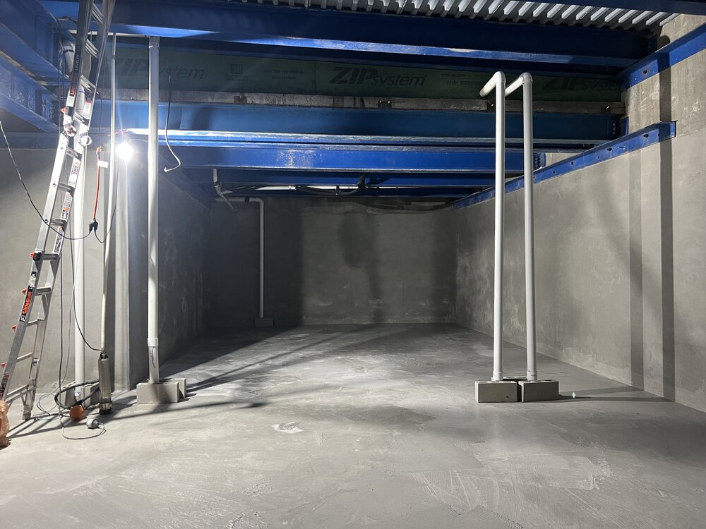

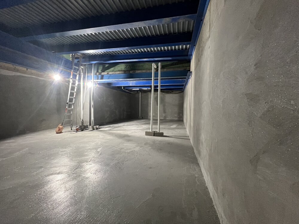

We did, nothing underground, basically drains in the trough of a butterfly roof then pvc through the house into a basement waterproofed concrete tank. Stored about 65,000 gallons. We have a shed roof too with a gutter than drops down the side of the house halfway then drains into the cistern through the subfloor. It’s enough for a family of four to live without much sacrifice or change in lifestyle.
Inside the tank is an aerator, pump, depth sensor, and a hatch that’s it. Pressure tank and filtration in the garage. Filtration is two carbon filters for particulate and UV light for microscopic organisms. Done and done.
I think the big cylinder poly tanks are an easier / better solution. Ours is a bit over kill.
if for landscaping only it’s super easy.
pex is a smart solution, there is super flexible pex and then the semi flexible. Great products.
here are a few pics of ours finished without water.
garage is above a lot of that ceiling, kitchen and mudroom too.

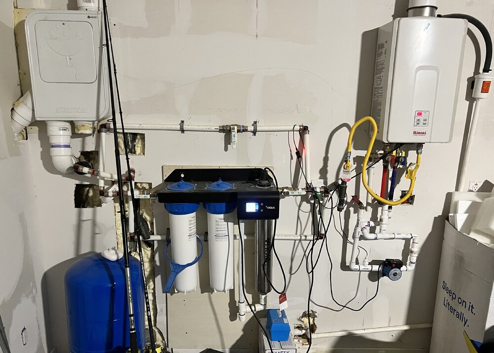

here’s the filtration, the box on the wall to the left is actually the first filter I didn’t mention above it comes through that from the roof and that filter catches big items. We don’t have much in the way of leaves etc so it’s a bit unnecessary. The box on the right is the water heater. The pressure tank is blue tank bottom left. The carbon filters and UV are the canisters in the middle the rest is the circulator pump. Apologies for the mess, I was really irritated about that I wanted a clean mechanical room and I got shit thrown up on the wall. Oh well, the system is pretty bad ass other than that eye sore.
Out of curiosity, how cold is the cold water coming out of the tap with that system? I would think with that much insulation you would actually get something fairly decent instead of the tepid bath water that comes out of the cold water tap in the middle of summer on a municipal system.
65 degrees year round, it’s a subtle luxury.  Also no spots on any dishes, no scale in the dishwasher or sink, faucets stay clear, taste is nice. I want to test for forever chems but haven’t yet. Down spouts in the basement tank are intended to minimize splashing so as sediment accumulates it will be left alone on the floor. Probably have to maintain/clean once every 20 years?

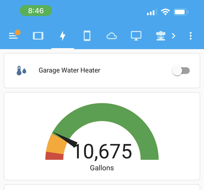

you can also go smart home on this stuff and add a sensor, here’s ours with a reading from last fall.

our system is fucking stupid, don't even worry about that. she did it so she could get green luxury home builds, the thing was a fucking boondoggle but if we count marketing for her business it will probably turn worth it/profitable in a few years.
the real gold standard imo for rainwater harvesting is to collect and store enough for your use, that's it. if you can avoid excessive piping all over the place for a nicer aesthetic that's good too.
for xeriscaping I'd hone in the following numbers:
* assuming no rain for 4 months, how much water do you need for your landscape?
* how much rainwater collection will your roof generate in one year (there are calculators for gallon per inch (annualized) x surface area)
* base that roof capacity on average rainfall minus 10 inches (that's what the last two years were)
that will back you into a tank size.
assume you need 500 gallons every two weeks for xeriscaping in the hot summer months. That's 4000 gallons over 4 months.
I bet your roof will generate 20,000 gallons easy, so you will have excess so your overflow drainage will be a major factor. or you calibrate to one gutter / one side of the roof but make sure your math checks out.
two ways to deal with overflow- use the water where you can (spring flowers might want water every other day, spring potted plants, etc.) - and then have an over flow plan.
Edited by troph

2 minutes ago, troph said:
What was supposed to be a $10,000 whole-house system turned into that.
LOL.
65,000 * 8lbs per gallon = 520,000 lbs of water.
There has to be $10,000 of structural engineering involved in that thing.
We collect 2/3 of the ~1000 sq ft cabin roof (barndo) into a 1550 gallon poly tank up at the ranch. Backside goes to a separate 550 gallon tank just for wildlife waterer trough. It is our sole source of water. Cabin was off grid for a few years. Still haven't done a well. Plenty for quick showers and toilet flushes on frequent weekend visits.
It is pretty simple. A 12v RV water pump moves the water via underground pipe, plugged into a cheapo 110v inverter. Can still plug into 12v marine batter as backup. I unplug the pump when I'm gone so that some leak doesn't flood everything and drain the tank. No major freeze damage to the tank bulkhead, but the pipes after the manual cutoff have burst if not drained adequately.
Rear tank is just a 550 tank on 4 courses of cinder blocks (28 total, 7x4). Enough height to trickle a wildlife trough about 75 feet away.
Rainwater gets into tank after going through leaf catcher and filling pvc first flush. I don't really water much with it, but I do douse with bleach every so often. Don't drink or brush teeth with the water. Sometimes I fill a 330 tank with overflow or pump into it and have a watering timer keeping a Monterey oak alive through the summer.
I think all my parts were just home depot 3" Pvc and assorted special bits from rainharvest.com. And those were just a downspout filter ($50) and a first flush T and float valve ($50).
6 minutes ago, Incredulity said:
LOL.
we started with two 10,000 polymer tanks in a tank room down stairs, no big deal.
it's hard to put pricing on what that ultimately ended up being because the steel order included roof reinforcements, the concrete was for a lot more than that, rebar for the foundation, but in the end, steel I-beams, steel corrugated tray filled with 3 inches of concrete over the ceiling of that thing, 18 inch concrete walls reinforced with rebar to a stunning degree, but other than the tank set up (Ms. Lincoln other than your husband was assassinated, how was the play) the rest is pedestrian just PVC piping run through the framing, a pump, pressure tank and ordinary filtration system. I bet that part is $7500 all installed.
anyway, enough about that, I'm here to advocate for simplicity and sustainability.
HOOOly Shit.
I'm laughing WITH you.  WOW, just wow.
5 minutes ago, Incredulity said:
HOOOly Shit.
it's borderline embarrassing, no I take that back it's just embarrassing. if she wasn't a builder that could show it off and capture monied clients with it at 25-30% cost plus builds I would have lost my shit and we would not be together anymore. y'all think having a builder spouse is a benefit, fucking-a man, think again, think again.
the last thing I will say - to give her credit - the house is built for the next 100 years not the last. even in the worst of a drought this roof will catch enough water for a family of four for a year. long term water shortages may impact irrigation and pool use but not ordinary use. the concrete insulated walls especially downstairs will keep the house comfortable even in 110 degree heat and the solar panels power as much as half the home's energy needs. we would love to see pricing come down and a way to bring these technologies closer to mass production.

random shot. Way in the corner is the leaf diverted and the vertical pvc is the first flush. I should have the tank right there, but instead I have these aqueduct to take the water to the 1550 tank. It used to be a straight shot, but I built a carport to park a kawasaki mule.
Next Pic shows tank. The bulkhead and important buts are in that wood box. Inside is a ball valve. The pipe goes to a hole in the screw top lid. There is a screen there. Overflow goes to a trough. Lil oak is in the wire cage. Temp piping because O was building the carport amd it started raining on me. Thumb top left.20240316_132614.thumb.jpg.f5ea25f73f5a7970128b941f2d1a798a.jpg
Thanks ROLF BOX for the hint about signing for rainwater collection to save the tax!  And the run lengths of guttering.  I have a long run cross the back and where I will need one downspout.
