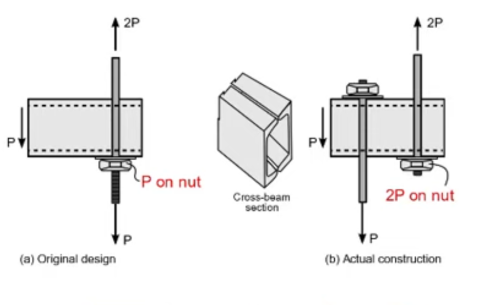

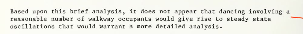

Yup, that was the GC who did that.  My dad headed up the structural engineering group (Civil) at Missouri-Rolla at the time, and he got brought in to consult on the post mortem.  The contractor had changed some of the joint designs and ultimately the natural frequency of the structure ended up aligning almost perfectly with the dancing going on.  It all started to oscillate (think Verrazano Narrows Bridge failure) and eventually came down.  It was  horrible.
Not trying to be a dick, but no, it was poorly designed and then changed to be an even worse engineering failure.
watch that video I posted above
from wiki:
The original design by Jack D. Gillum and Associates specified three pairs of rods running from the second-floor walkway to the ceiling, passing through the beams of the fourth-floor walkway, with a nut at the middle of each tie rod tightened up to the bottom of the fourth-floor walkway, and a nut at the bottom of each tie rod tightened up to the bottom of the second-floor walkway. Even this original design supported only 60% of the minimum load required by Kansas City building codes.
This design change would be fatal. In the original design, the beams of the fourth-floor walkway had to support only the weight of the fourth-floor walkway, with the weight of the second-floor walkway supported completely by the rods. In the revised design, however, the fourth-floor beams supported both the fourth- and second-floor walkways, but were strong enough only for 30% of that load.
Jack D. Gillum would later reflect that the design flaw was so obvious that "any first-year engineering student could figure it out," if only it had been checked.
The original design was very fucked up then the changes were proposed by the steel contractor and approved over the phone by the engineer. The dancing didn’t help but they weren’t hitting a natural frequency to cause the collapse the walkways were just totally fucked up and barely able to hold their own weight.

Yes, wiki is the ultimate arbiter of engineering design.  It was absolutely a dynamic failure related to resonance.  I won't argue this any more, believe what you want to believe.
Actually the engineering is the ultimate arbiter. You said the GC blew it, which they did, but also the engineer definitely caused those deaths. Maybe you have the inside scoop from your dad about resonance but NIST didn’t say that was the cause. Is your Dad Ron Hamburger from SGH?
pg. 229-232
https://nvlpubs.nist.gov/nistpubs/Legacy/BSS/nbsbuildingscience143.pdf
Just watch that video it explains it pretty clearly, simple statics —
Tough way to learn but every structural engineer studies the engineering failures that happened at this walkway because it was so catastrophic. Most deaths due to structural failure in US history and all.

No doubt there are horrible design decisions made all the time.  His relation of the story to me -- and I was a mechanical engineering student at the time, not wholly incapable of understanding the statics and dynamics -- was that the net load capacity was capable of handling the party weight.  As you say, factors of safety are built in to those calculations.
He once had to deal with a company that hired one of his worst students on a co-op semester, and this dumbass had put the rebar on the wrong side of a retaining wall (so the rebar wasn't taking the tensile load it was intended to take).  Shit definitely happens.  People still sign off.  When contractors fundamentally change designs, that's just a whole 'nother level of malfeasance.
