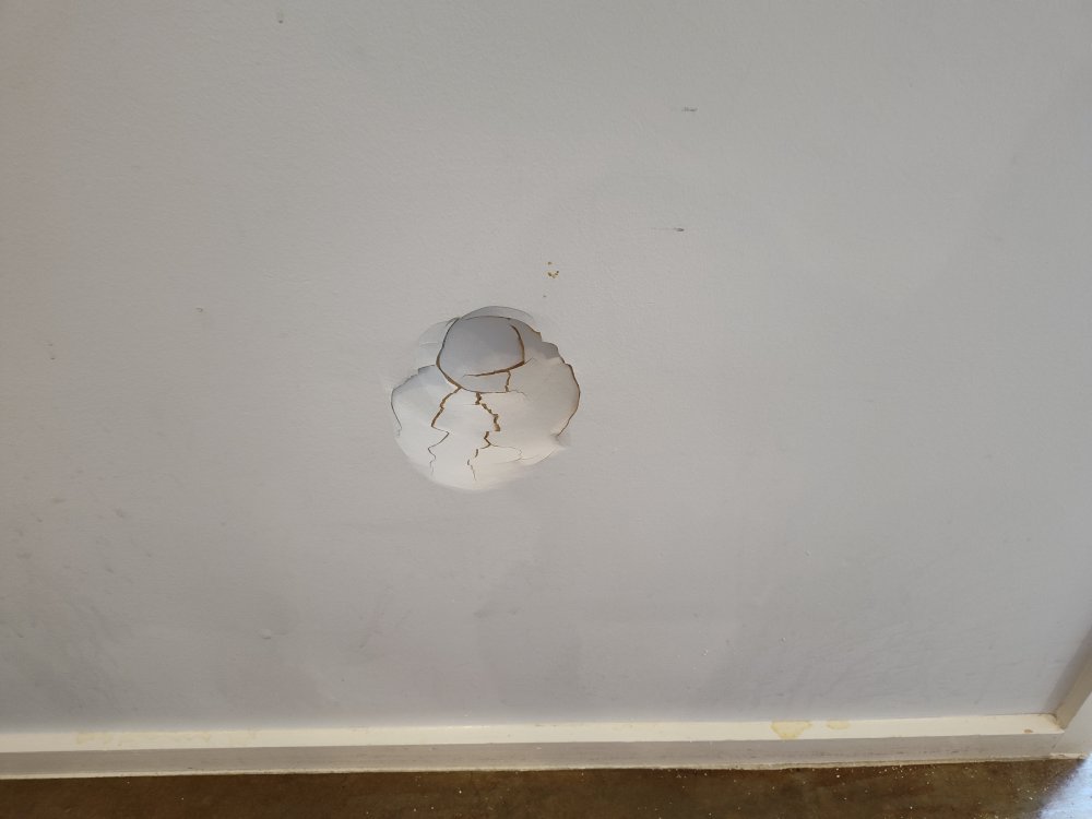

8 hours ago, MissingInAction said:
My drunk ass friend took a header into the wall leaving a dent about 12 inches across.
Any recommendations?
Drywall is super easy to repair. Lots of YouTube videos. If you’re not near a stud, just cut out a square around it, buy a half sheet from HD, cut similar size square. Get 4 small pieces of scrap wood and hold them inside the hole and use drywall screws to secure them. Then screw your piece to scrap. Fill gaps with mud, tape over. Doesn’t matter how bad it looks because you’re going to sand it and it and out more mud on (thinly).  Mud and sand until you’re happy.
matching the color of the paint will be the hardest part.
In addition to the above, with larger holes like that, I also like to leave about 3” of extra paper around the replacement piece.
Cut a square out around the damage. Measure the replacement piece to fit. Then measure out 3” from all sides and draw another square. Cut the outer square clean. Score the inner square (on the back, of course), but go all the way to the edge.
Snap off each side, but peel the pieces off the paper front.
Now you have a replacement square, and cover the seams similar to how they tape the joints.
Once you get the new piece screwed into your brace, lift the edges and fill the gaps. Then you can do a skim coat over the top. Feather it out good, sand, tweak until satisfied, then prime and paint. I’d paint the whole wall to ensure it matches.
It's super easy to repair if you don't mind it looking shitty after the "repair" is done.

5 hours ago, UT_OB1 said:
matching the color of the paint is the easiest part.
Take a chunk of the damaged drywall to the professional paint shop of your choice (paint desk @ Home Depot, Lowe's, Sherwin Williams, etc. & they can do a 100% color match.  More than likely, a paint sample cup will be enough to cover that area however a quart isn't that expensive & who knows if he will do another header some day.
Get a cheapo paint kit (brushes, etc) & for less than $ 50 total (+ the repair kit shown above) you're good.
