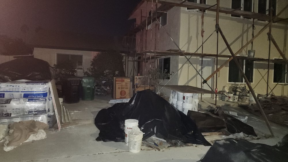

Eh. I think it annoys the neighbors more than it bothers us.
Guess who DOESN'T have an HOA? hehehehehehehe
Also, here's a fun game: Find the mailbox
hell, find the front door
