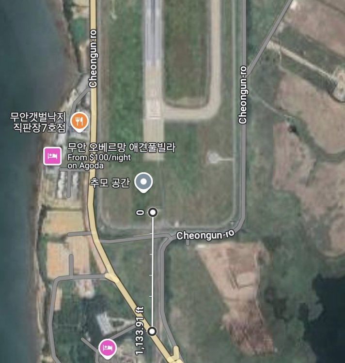

1 hour ago, t_eight said:
At the speed they were going they were likely going to skid into other residential/commercial structures.
Had what looks like about another 1100+ feet of mostly green space before what appears to be an elevated road
that road isn't elevated. source: street view.
Then even more potential space to slide along.  I mean at some point there could have been tumbling, turning etc so who the hell knows but just like any race wreck those usually are not the worst ones vs the sudden stop wreck.
