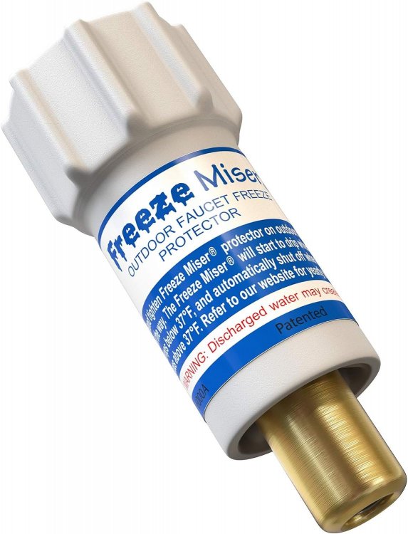

Also, as a gripe, I have these Freeze Miser faucet protectors on my hose bibs with northern exposure. The idea is that you connect these, turn the hose bib all the way on, and when it gets below about 37 degrees it starts to auto drip your faucets for you, to keep them from freezing.
They usually work great. Except that someone (and I don't know who, it could have been the wife, could have been some workers we had at our house over the weekend), decided to turn the handles to off. So the hose bibs froze over anyway.
So I have that going for me.

So, I have some of these (bought in planning for the 2021 freeze):
shopping?q=tbn:ANd9GcRChHH-vY59csLu9gZ4U
They work great -- when it gets below 35 or so, the internal thermostat trips and they throw off moderate heat, enough to keep any pipe they're in contact with from freezing.  But, two issues....1) they depend on electricity (so, in 2021, fuck me -- my whole "keep shit from freezing" plan was electricity-dependent), and 2) they are long and really designed for protecting longer lengths of pipe.
What I would LIKE to find is something like that in a much shorter length -- like 18-24 inches.  You can then wrap that smaller length around the exposed exterior faucet, cover it with something simple (seriously, I used coffee cans and whatnot) to make a shelter from the wind and something to retain the heat), and then pretty much "set it and forget it" for the season.  When it's not freezing, they are dormant.  When it drops to freezing, they trip on, and warm your pipes.  They should make a Texas version of these for just that purpose.  I've found a 3-foot length, but that's still a bit too long.
Oh, and we re-routed a faucet that ran through the garage to an exterior wall - we installed a shutoff valve for that right next to the interior wall of the house, so we just shut that pipe off and drain it.  That's the main pipe that burst on us in 2021, so we just eliminated the risk.
A buddy and I came up with that "freeze preventer" concept probably 12 years ago.  We never filed a patent.  Eventually, they hit the market.  That was a swing and a miss on our part.
What's really annoying is that hose bibs "up north" are designed so the valve is well inside the wall, and you can just close it and drain it.  I don't know why (or if) they aren't available here.

Yep. I've been searching for a long time for something just like this. Something like 4-9" (twss) of bendable heat tape with a housing to cover the bib.  As you have detailed, all the heat taps are much longers or become very cost prohibitive. This seems like a slam dunk for those of us on slab with exposed bibs.

Agreed, these have worked perfectly for me every freeze.

they are definitely available.   put them on every house we build.

I'm kinda serious about these exterior pipe protection setups.  Why don't they exist?  They should, and they'd be super cheap to produce (I know a guy in manufacturing in Gyna).

And seriously, a simple setup to warm your pipes only when the temp drops below freezing, triggered by a simple thermostat, so it's idle most of the season except for the handful of hours when it's needed, seems like a no-brainer throughout the south.  Put our product in Wal-Marts, Buccees, and Dollar Generals, and.....

I install them on all new homes.  Not that pricey of an upgrade.

I haven't had any fail, but I suspect the pipe leading to hose bib would freeze anyway in an unheated space if it got cold enough.
I haven't had any ruptured pipes in homes that were done in PEX, or copper and spray foam. Even had a temp PEX waterline survive the last major pipe destroying freeze- it was laying on the ground unisulated.  Swelled  up but never ruptured.

PEX is great and extremely durable, there's some good freeze tests on YouTube
In practice I don’t recommend the manifolds, especially for the hot side. Adds a ton of water volume before you get hot to the fixture.

I wonder why they start to drip at 37 and not closer to 32. It's not water starts to freeze at 37.
