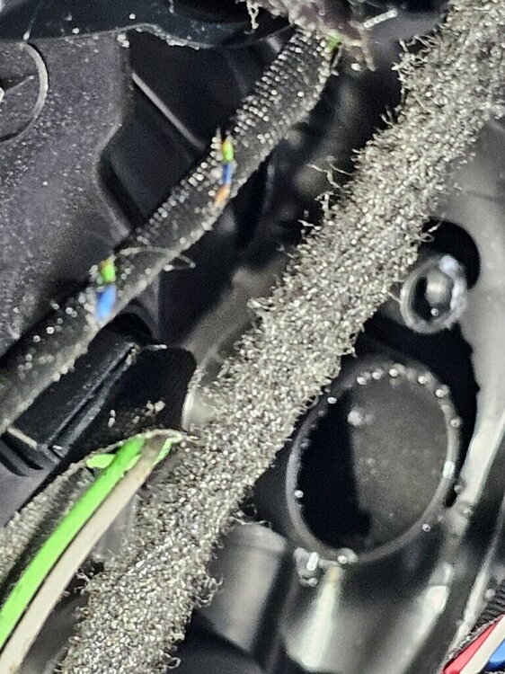

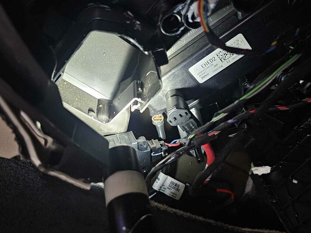

Wife drives a 21 glc300 - about 60k miles now. We had the "pleasure" of a 5.5 hour drive from SA to Houston yesterday (thanks a lot Seguin road construction) with no AC, and, possibly, heat running.
A buddy in Houston has a friend that is a mechanic (builds old muscle cars). He looked at it. he couldn't really diagnose the cause of the issue. His perception - the drain is not draining as well as it could. He said water was finding its way into the "case" and it was defniitely making some electrical components wet. He mention the various door/actuators not functioning as appropriate and pontificated that the water might have been causing the heater (allegedly located at the bottom of the "case") to kick on. Water was so voluminous that it was even finding its way to pad under the carpet on the passenger side.
He blew the drain line out, opened the "chest" vent actuators and told us that it should work fine on the way home if we left it set and running and didn't use "auto". Just set it on cool and adjust the fan speed.
About an hour into the ride home the same sounds and lack of air that ruined that lovely drive to Houston reappeared. The fan began making a high pitched sound and it felt like the heat was on. Air flow out of the vents felt VERY restricted (like 10% of what it was). I was literally about to drive the car into the concrete and call it a day.
On a lark I turned off the compressor. For about 3-4 minutes the air was "cool" and the fan was blowing "normal" and hard. then it started blowing "normal" but warm, which is what I expected. I turned the compressor back on and it worked again like it should.
I talked with the mechanic hoping the new data would help him diagnose. He offered some educated guesses, but it doesn't seem like anything more than that. It's very possible that one of the components got wet and sending faulty signals to the module for the ac system causing the actuators to change modes from ac to heat at the blend door actuator and or mode door. Is it blowing out the defrosted or floor vents. Also if you have a chance to stop look under the passenger front door area near the transmission. That's where the drain should be dropping water.
Anyone here ever dealt with this? I am uploading two photos he took and here is what he told me. "Water coming out of the hole in the larger hole in the first picture. Also out of the vent that goes to the lower passenger dash panel. Water is coming out of several areas. Also draining on the floor under the carpet from ac case. I blew out the drain hose. There may be something inside the case not allowing it to drain properly. "

Too bad thats in Austin and I am in San Antonio. I do appreciate the recommendation, though. I took the time to consult AI this morning and have some additional theories to process through. They are logical. It starts with evaporator core freezing - restricting air flow. This could explain why it progressed from "Working" to not and then back to working after running it without the compressor for 5-10 minutes.
The question would then be why? Low refrigerant? Possible. Water not draining? Possible. Given the observations of the mechanic, the drain issue gave him the most concern as a concept because of the amount of water it was producing to locations that are not ideal for water (including lots of electronics). Maybe there is something blocking the the line inside the case.
In any event - I think I have enough data to talk semi intelligently with a tech that is trying to convince me that its fubar.
I am still open to ideas if anyone is more experienced than me - and chat GPT.

closing the loop - evaporator core had a "crack" and leaked. Replaced under warranty (really) and we are back up and running.
