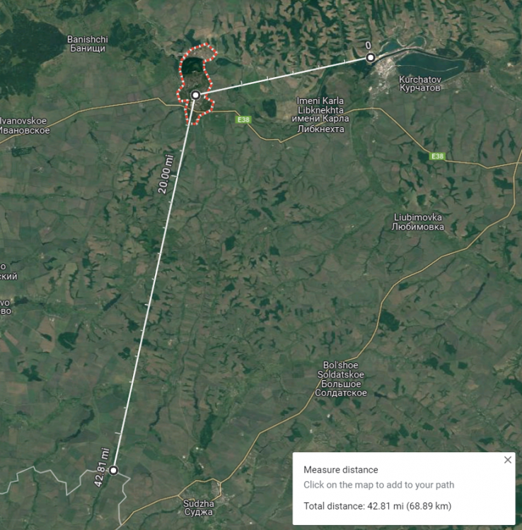

21 minutes ago, bolverk said:
I wonder if that reservoir next to the plant serves as the fresh water source for Kursk?  Just in looking at the satellite overviews it's really the only large body of water I see.  That isn't to say they (the Russians) wouldn't have other places to source water from, but that might be where the bulk of the water treatment for the area is done.  This would make some sense, as if you have a humongous infrastructure project like a nuclear power plant, dam and reservoir, why wouldn't you do treatment there as well?
I'm not sure that shutting off water to ordinary citizens is a great idea (it may well be crime, which the Ukrainians don't want to commit) but if push comes to shove, armies require water.  In any event, capturing this area may well mean that don't just control the electricity in the area, but you also potentially control water as well.
