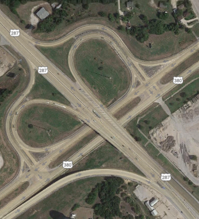

The TxDoT engineer in Wise County for years was an aggy. He designed some real headscratchers and people died because of it. The interchange of 380 & 287 is a prime example.
Heading north on 287 and exiting to 380. Speed limit 55, steep downhill and a 20 mph horseshoe. They could have put in a traditional interchange, but that would have required taking part of the OLD TxDot yard that they use for absolutely nothing. Can't count how many trucks have flipped trying to make that turn.
Heading south on 287 and exiting to 380 you have a weird S turn then have to cross 2 lanes of 55 mph traffic. Same thing for exiting 380 E to 287 S or N. There were so many fatalities they finally had to admit it was a bad design and add an onramp from 380E to 287S. He originally said that ramp was impossible.
