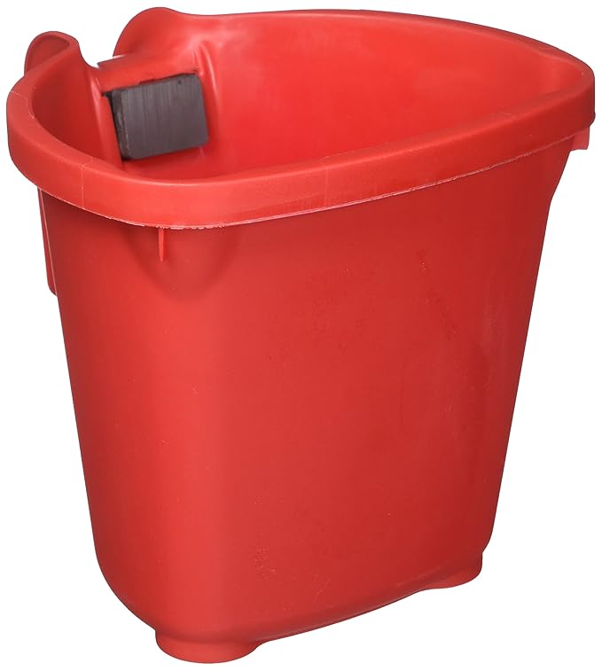

You probably won’t do it in a day. Make sure to get a can to put the paint in. I got a cut in bucket at Home Depot with a handle and a magnet on one side. Pretty damn handy.
As he said, these are your friends.
